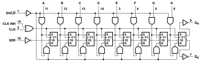

Try setting the clock pin high at the start of loop(), before the latch pin is set high.
I think the problem here is because of the way the 4021 works compared to the way shiftIn() works. If I understand the data sheet, when the latch pin goes low, the value read from PI-8 is immediately available at Q8. But the first thing shiftIn() does is set the clock pin high before it reads the data. This shifts the value from PI-7 into Q8, loosing the value from PI-8 without ever reading it.
Setting the clock pin high first should prevent loosing the value read from PI-8 before it is read.

PaulRB !! You're a D Genius ! it worked perfectly !! 😃
but please explain what made you give this solution in the datasheet ? because i read the datasheet and did not notice anything unusual

> firashelou:
Well, that's what I tried to explain in my previous post.
Here's the code for shiftIn():
```arduino
#include "wiring_private.h"
uint8_t shiftIn(uint8_t dataPin, uint8_t clockPin, uint8_t bitOrder) {
 uint8_t value = 0;
 uint8_t i;
 for (i = 0; i < 8; ++i) {
 digitalWrite(clockPin, HIGH);
 if (bitOrder == LSBFIRST)
 value |= digitalRead(dataPin) << i;
 value |= digitalRead(dataPin) << (7 - i);
 digitalWrite(clockPin, LOW);
 return value;
You can see that it sets clock high before reading the data pin.
Here's the logic design for 4021:
 ![74hc4021.PNG](https://europe1.discourse-cdn.com/arduino/original/4X/9/c/f/9cf50f068ff7bc898e6ea468b8f38f43006cf529.png)
And for 74hc165 for comparison:
 ![7fhc165.PNG](https://europe1.discourse-cdn.com/arduino/original/4X/3/2/d/32d4abbd33cb3d36f3cd08302b128a6cab2bcae5.png)
@Mike, would the OP have had the same problem with 74hc165? I can't quite work it out.
> ![74hc4021.PNG|1013x355](upload://movwjznG9q1vC9uRIyJN3oGNC0V.png)
> ![7fhc165.PNG|1145x355](upload://7fFw9ZL5Kn7kdTzPNEWs3WSl5iZ.png)
I can't quite understand what is happening on the circuits, i mean there is a NOT on both Clock and Latch which will give low if set high, then the NAND which will give 1 if both are 0 but then what and I don't understand why all the inputs are a NOT and not a hex buffer ?
I think you are miss understanding two things here.
1. a hex buffer is not the name of a type of buffer, it is the name of a chip that contains six buffers. Chips like the 74xx14 or 74xx04, the xx denotes the technology like LS or HC to HCT to name but three of them.
2. while that is a logic diagram of the circuit, it is not the actual circuit they use to build the chip. It is the equivalent circuit. The real circuit they keep a secret because in the end of the day it is all made from NOR gates as that is all you need to make any logic circuit. You could use NAND gates as well but a NOR gate is simpler to fabricate so they don’t.
All inputs are buffered so they only present a one gate load to the connecting circuitry. In the case of the earliest TTL logic gates unconnected inputs would float high, so many of the compound logic ICs like this are designed to have a logic low to activate an input. When other technologies came along these conventions were kept for compatibility reasons.
I think not. The description of the shift in function from [here](https://www.arduino.cc/reference/en/language/functions/advanced-io/shiftin/) says:-
> If you’re interfacing with a device that’s clocked by rising edges, you’ll need to make sure that the clock pin is low before the first call to shiftIn(), e.g. with a call to digitalWrite(clockPin, LOW).

> Grumpy\_Mike:
thanks Grumpy\_Mike for taking the time to explain but I think too much technical info which are hard to get for me 😕
