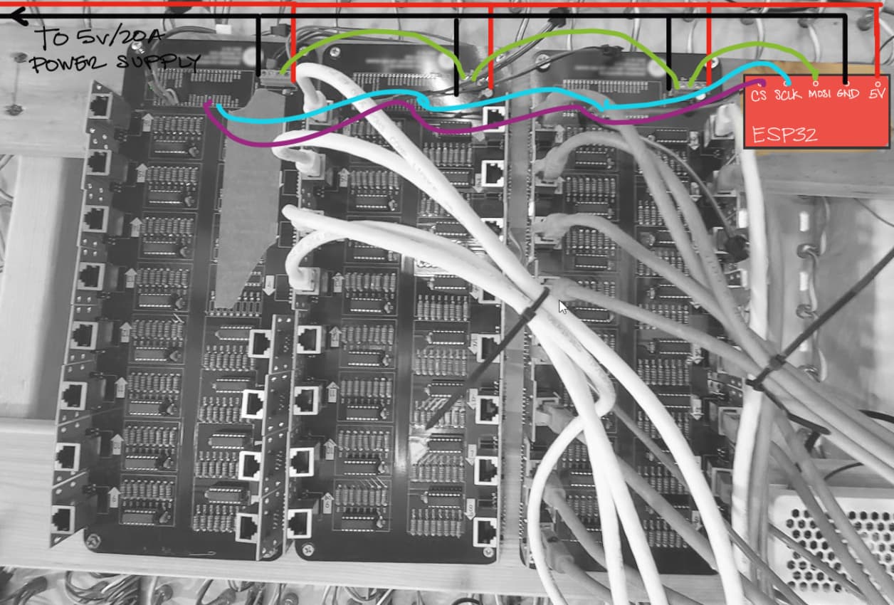

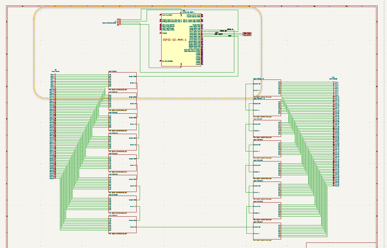

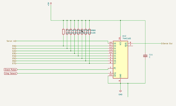

Shift Register Chain stops sending correct sensor data after 32 registers
I have created a series of PCBs to collect sensor data from an array of hall effect sensors. The project description is here LED Pegboard with 2,000 sensors
The problem... after hundreds of hours of preparing, designing and testing I'm now installing and I am hitting an issue. No matter what configuration I use, I cannot read from more than 2 of my custom built PCB boards...
For the code, I'm just running the CS and SCLK manually with a loop over all the bits. Its very slow, each clock pulse is 1000 microseconds, which is fine for the use case here. The hall effect sensors are pulled high. Every sensor when triggered returns low, as expected, up to the sensors on the third board. At that point, triggering one of the sensors on the first register (sometimes its the first, sometimes its the 7th.. ) returns every bit after it as low. I have a total of 9 boards in groups of three, so I've moved around the boards and tried many in the third position and the result is always the same, so I don't think it is an issue with the PCB.
I have one hint, in that I was having similar issues with noise on just one board which I solved by shortening my ground line to the ESP32 board as much as possible, or using two wires... I'm not sure why that solved the noise problem, but perhaps it is linked to this problem.
My fix at this moment is to add another ESP32 for the third board. It seems to work fine. But I'd like to understand why this issue is happening.
Below is a photo of the custom PCBs I made. It is only partially connected in this photo, but my question stands for fully connected boards. Its a mess, I know, but bear with me:
The ethernet cables are connected to hall effect sensors, each cable carrying 8 sensor signals. The boards direct the signals to shift registers which are then controlled by signals from the ESP32 board. The boards also trace the power, clock and chip select signals to all the shift registers. The data line daisy-chains from one board to the next.

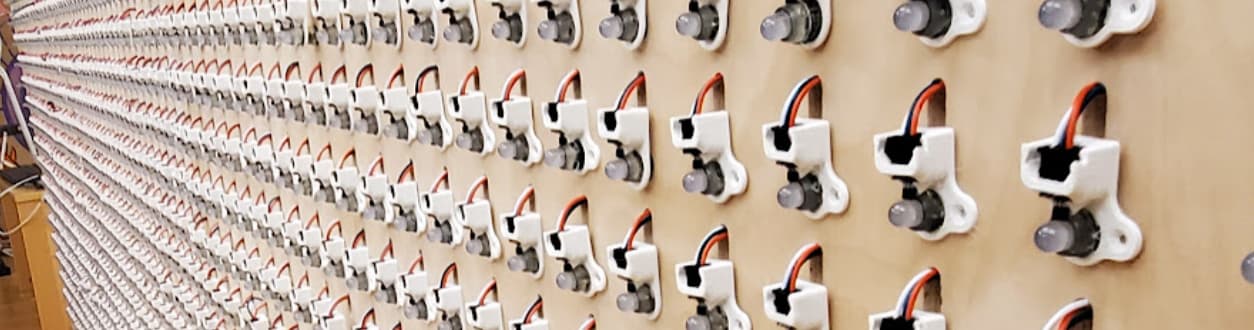

And a closeup of the actual sensor mounts:

  Is there any buffering of CS/MOSI/SCLK?  Possibly a fanout issue?
If you have the tools (scope, logic analyzer) it would be useful to check the waveforms as they get farther away from the source.
I see you power the shift registers with 5volt, and drive them with 3.3volt logic from a weak ESP pin, or do you have a level translators and buffers between ESP and shift registers. Do you have any termination at the end of those lines. Love to see a diagram of this.

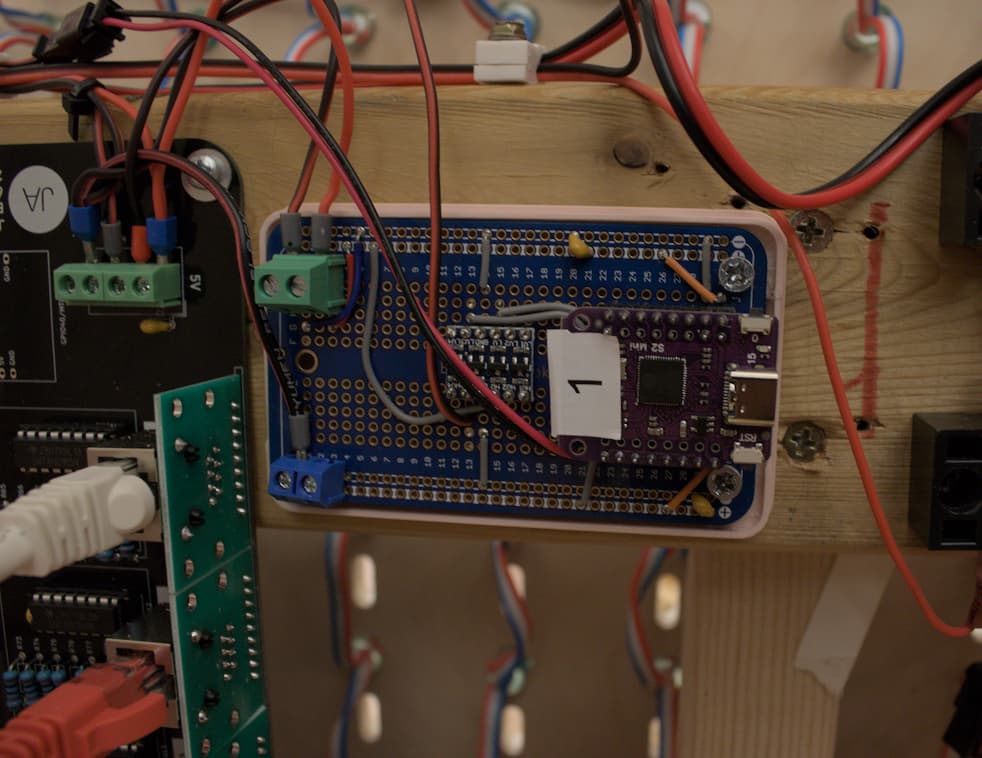

I don't have any buffers per se, and while I'm level-shifting the incoming data down to 3.3v, I am not up-leveling the clock and chip select... I could see how that might be an issue. That would be a trivial fix with the bi-directional level shifter.
Hmm, no buffering... i'm not sure how to implement that. I have a hand-held oscilliscope/multimeter, I should sit down and check the waves at each board... I am not sure my scope is particularly the right tool for this, though, it seems quite limited. I'm still learning how to use it.

The fact that it is exactly at the start of the third board suggests a poor wire connection to me, specifically the data connection. Are you very sure this is not the case, e.g. by swapping the PCB order?

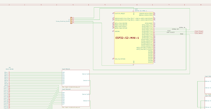

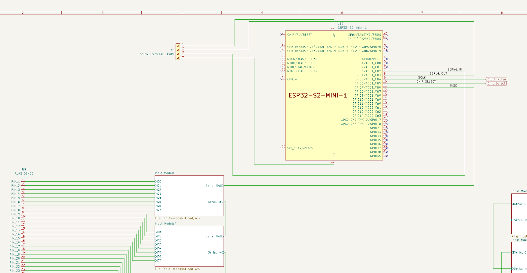

dataPin should be MISO, not MOSI. You're reading data.
MISO needs level shifting down to ESP levels.

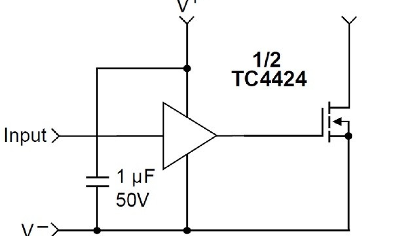

The CLK connects to all chips so needs sufficient drive. A buffer is needed, also to bring this signal up to 5V.
Sorry, did the drawing late for me, it is MISO. The level shifter is brining the data down to 3.3V.

It's a voltage-only level shifter, with a weak HIGH and a LOW with the same current as the ESP pin.
A TTL level shifter chip has proper "power" outputs.
Did you see that I also mentioned "termination".
You might have to use a resistor to ground at the far end of the clock/data wires, to minimise ringing. Try ~470 ohm. Or, better, 1k to ground and 1k to 5volt.

I see, the SN74ACHT125 is a buffer, really, but will also bring the 3.3v up to 5v, or vice versa. Should i be adding one in between each board then?
Also, for terminating, here is the PCBs shown with the clock and select traces isolated. Should the termination be where I'm indicating with the red arrows, or can i do it at the top of the board? At this point, I have to jump the pins with a wire.

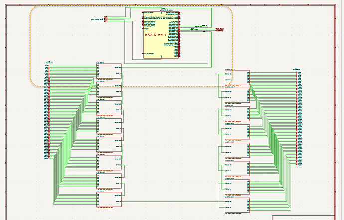

Also, here are some screenshots of the schematics. My original plan was to put an ESP on each board to manage the data and push it to the next, but that seemed overkill, so I jumped the Serial Input terminal to the serial input to the last register and the serial out to the Serial Ouput terminal. I changed the ESP32 board to the S2mini in the schematics, so they don't match the PCB 1 to 1, but are functionally the same:
Overall Schematic
Closeup
Shift Register Sheet "INPUT MODULE"
No, just try buffering the data/clock outputs of the ESP first. And chip select.
Level shifting of the input of the ESP can be done with two resistors (1k:2k).
As said, only at one point, and at the end of the line.
Furthest away from the buffer of the ESP.
But leave that for last, so you can see what fixes your problem.
I expect you need both.
Leo..
