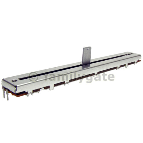

Since there's no potentiometer, should I add one into the mix (and how would one do that)? If so what is the best way to wire and code that in? Or could I 'guess' the position of the actuator by timing it (ie, 5 seconds of activation = 50% Extended)? I could see the latter being a problem if UP/DOWN buttons were used for manual positioning.
