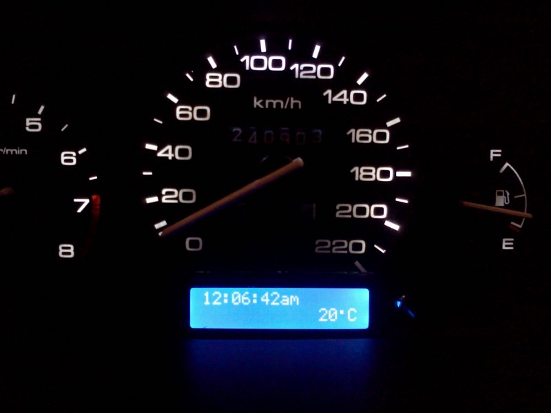

I have successfuly written a code for MPGuino to pop up warning text, if I am on display that shows me clock and temperature readings and if temperature readings show less than 3°C. The only problem is ... that when I'm on that display it keeps on showing me that XD
Here is the display without the warning text:
  1. Question:
    MPGuino has several displays, showing you all sorts of stuff :slight_smile: Would it be posible that nomather on which display I'm at, it would show me the warning text if temperature is bellow 3°C ? But that it wouldn't show me the warning every time I switch between displays.
2,3. Question:
How should I change the code so that it would pop up text only once? :relaxed:
Or, that it would pop up text for, lets say 5 seconds and then stoped bodering me abouth that, for at least 10 min? :astonished:
I've tried with delay, but the problem is, that I can't move between other displays until the delay stops. :~
I hope someone understands me and my problems :slight_smile: :slight_smile:
