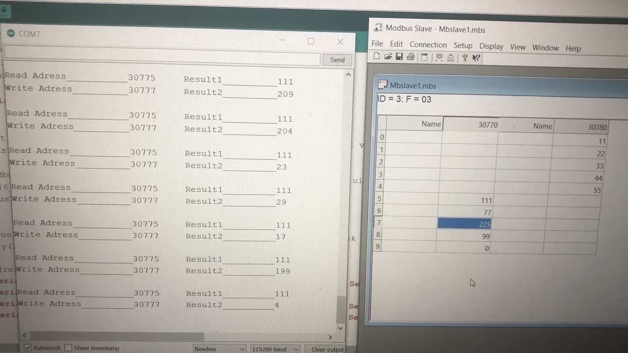

Hi everyone,
I am using Modbus Master Simulator on my Windows PC to read the correct address and register from my inverter.
That works well
I could really use some help, after reading through everything I found on the topic I can't figure out why my sketch below won't return the right value, or any value (res is always 0).
Any help would be greatly appreciated. The magic should happen in the last few lines of code

I figured it out :slight_smile: for any body looking for the same answer see the code below:

Here's what I tried to test a Modbus TCP connection:
ESP32 (Modbus server) <<<---- wifi ----->>> laptop (Modbus slave)
IP addr: 192.168.0.104 ----------------------------IP addr: 192.168.0.43, Port: 502
-------------------------------------------------------------Unit (slave) ID: 3
-------------------------------------------------------------Address: 30775
The ESP32 acts as the server while the laptop acts as the client running the Modbus slave software from modbus tools (https://www.modbustools.com/download.html)
I tried reading and writing (random values between 0 to 255 into 2 different address and it worked so far.
  • Read from Address: 30775
  • Write to Address: 30777
