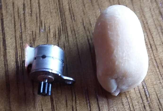

A BC547 is a small-signal transistor, with an absolute max collector current of 100mA.
Not suitable for motors larger than a pea.

Does this count?
Peanut, not a pumpkin.
I think you win!
That was seriously funny. :slight_smile:
