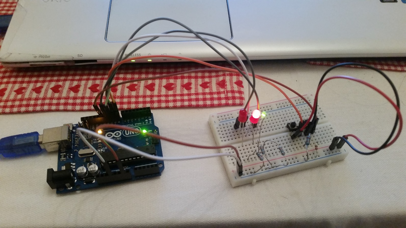

I am very new to arduino and I am struggling with a simple thing. I am getting suspicious if my arduino board is broken or something. Anyway, I wrote a simple code, which is;
pinMode (11, OUTPUT);
pinMode (9, OUTPUT);
pinMode (10, OUTPUT);
digitalWrite(11, HIGH);
digitalWrite(11, LOW);
so I am expecting only #11 led to blink but #9 &10 are also on, I even added these lines in the loop;
digitalWrite(10, LOW);
digitalWrite(9, LOW);
but they still turn on. but if I want to blink #9 & 10 they do blink and the outputs work properly.
I deleted the lines that I declare #9 & 10 in the setup and they turned off only that way.
I cant understand the problem.
Can you help me with this please?
Thanks

Do you have LEDs on 9 & 10 to show that they are 'on'?
If so, how do you have them hooked up? Pin to anode, cathode to GND, or pin to cathode, anode to 5V? With resistors, of course?
yes sure, I attached a picture, the led on the left is connected to #11 and it is blinking, the other ones are connected to #9 & 10 and they are constantly on.

Have you read the labels on the pins that you connected to? Your breadboard(-) is connected to +3.3V and your (+) is connected to ground.
Let me guess, you found the polarity of the LEDs by trial and error plugging?
You have wired your LEDs to be ACTIVE LOW.
Follow the 5V pin on your Arduino. The white wire.
It goes to the LED, and then into one of the I/O pins.
You are using the I/O pins as the GND.
In other words, whenever your pins are LOW, the 5V can come through the LED+resistor and turn on.
Furthermore, your pin 11 which you think is working correctly is actually not. If you change the delays to be offset, like HIGH for 1000ms and LOW for 5000ms, you will notice the LED is actually OFF for 1 sec and ON for 5 sec.

WRONG! Wrong wrong wrong wrong wrong and multiple people have told you this multiple times.
HIGH means that the pin is driven to 5V. LOW means it is driven to 0V. That's it. What those voltages do depends entirely on the circuit the pins are connected to.
Your first mistake is that you have the power connections to the breadboard backwards. You have 5V going to the blue side and GND going to the red side. This is backwards from the normal convention, and has also been pointed out to you in a previous post.
Everything else follows from this "mistake". That's why it seems backwards.
A look at LEDs D3 and D8 in the image.
If Arduino pin 13 goes LOW, LED D3 will turn ON
If Arduino pin 8 goes High, LED D8 will turn ON
Do you see how both LOW and HIGH can make a LED go ON?

It's not just that they're connected the wrong way around, they're connected to the wrong power rail. If you want them to be active HIGH, they must be connected to GND not +5V.
