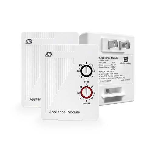

X10 devices use mains power for data transmission. Great care is required when testing, or you could damage yourself.
