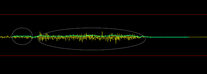

This might be a long shot, but I can't seem to be able to simplify a signal collected from an EMG sensor.
I have tried most of the arduino signal filters available online : https://github.com/sebnil/Moving-Ava...duino-Library-
http://www.schwietering.com/jayduino/filtuino/
but they don't really give me the signal that I need to control a set of leds.
What I'm trying to do is to compare logged data to real time data and control a strip of neopixel leds. However, since the signal is so jagged by its nature, I'm having a hard time finding matches when I compare it. I'm attaching an image of the signal, in yellow is the actual plot of the real time data with me mildly contracting my muscle, and the larger circle is a full contraction. In green is what I would like to get.
I'm attaching the full code, and posting here the two functions that read and compare and the filtering that I do know.
Your help would be tremendously appreciated since finals are around the corner!

I am not understanding your terminology but after reading it the gist of seem to be (without having specifically stated it) is that you want to AMPLIFY the signal. I really don't know what you mean by SIMPLIFY. There are basically only two terms that apply here, neither of which you have used. The first is AMPLIFICATION. This is what you need to do before applying the second term which is
SIGNAL CONDITIONING. After doing that , you could go on and apply an FFT , but let's keep it SIMPLE for the moment. You are
wasting your time trying to read the signal with the ADC on the arduino , unless you use the
analogReference(INTERNAL);
statement which will immediately limit your analog range to 0 to 1.1 volts, which it would seem is more appropriate for your signal.
Without any amplitude data for your signal (while you image looks nice, it has no amplitude data) there is no way to know what you are receiving in terms of analog values. Your code has Serial prints but you did not attach a serial monitor terminal capture file showing what you received. If you do that , we will have a better idea of what we are dealing with. It would seem that you need an analog input amplifier (op amp). We can talk about that , when we know more about the level of your signal.
Thank you for your reply raschemmel, you are absolutely right about me using the wrong terminology. I frankly don't know what is the appropriate name for what I need that is why tried to draw it in the image so someone would guess :grin: what I'm asking.
With that said, I'm using Teensy 3.1 which is a 32bit arm processor and it seems to be doing very well. at collecting the data.
I'm attaching a log file that mainly has data with the arm at rest.
I can add one with me doing full contractions if you think it will help.
GMOTION3.csv (13.7 KB)
Have you checked your data if there is an interference between channels? Simple ground one input at the time and see a data log, if there is "0" leaking in the neighboring channel.
Looking at the diagram, my understanding that green line represents an envelope of the signal. You can't get envelope using LPF, as the nature of your input a noise similar, or AC signal. First of all, you need subtract DC offset from your data ( offset is a value w/o a signal), than you may run averaging or similar LPF filtering using squared up values ( x^2).
Magician I don't seem to have any leaking 0s if you look at the csv attached in the earlier post. You can see the values.

You don't understand. I have seen repeating data in channels, like 468, 468, 487 - there is no way you can be sure, that data from channel 1 is not jumping to channel 2.
Ok, I see let me double check. I forgot to mention, that from the 3 EMG shields I'm currently only using 1 to test the data and the other are just floating.
