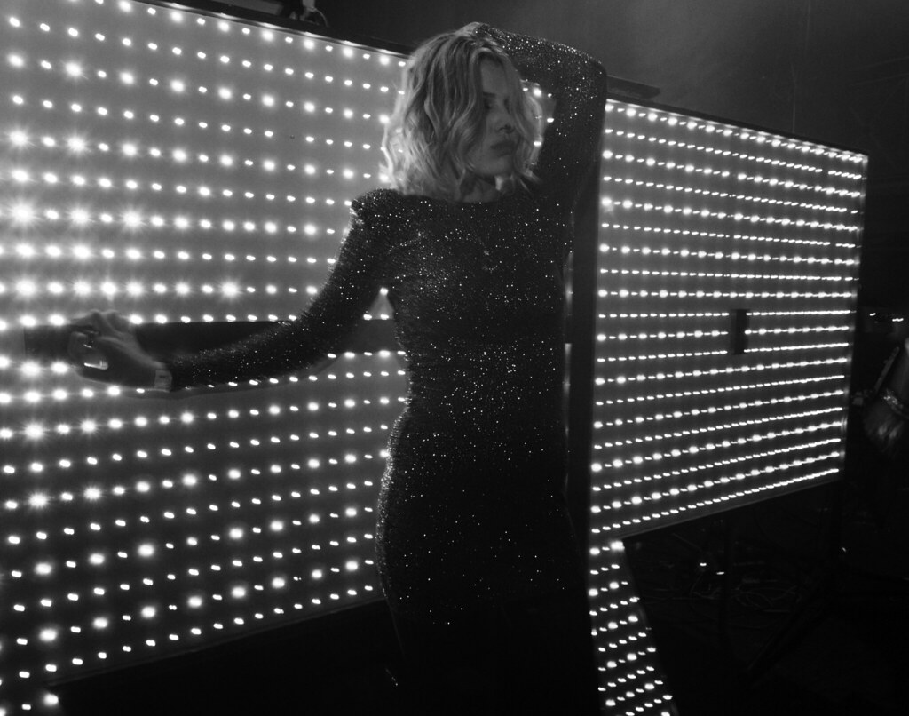

I have a hefty project to fix, The new years party was a success, I managed to turn data/clock line corruption into my advantage (programming the effects took minutes - as there wasn't much I could do thanks to bad signals, lol)
Anyhow, here's a pic to excite you:

So far, $1000 +/- 50, over 1500 feet of wire (loads of antennas), 1474 LEDs (7 broken = 1467 working LEDs), and loads of man hours
