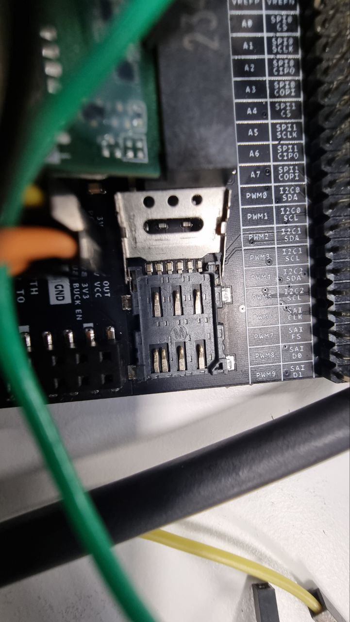

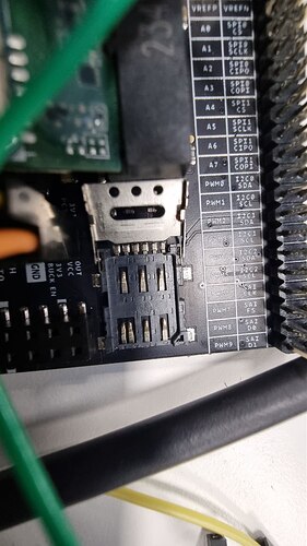

Hello again, so i was thinking, the issue might be with the connectors that make contact with the SIM instead of the handler, i am convinced there is no short circuit and I tested the connection between the 3v3 PCIE and 3v3 Buck and it is Ok. Attached is a picture of the metal contacts, is anything wrong with it?

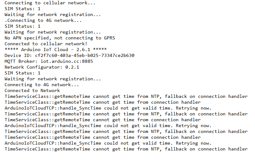

hey, so i ordered a new mid carrier and it seems to solve the issues.One of the pins on the simholder had a short circuit apperantely. Now i am confronted with the following issue.
I tried configuring the time of the 4G EMEA global to current time but i think it still did not work, does anyone knows how to set the time of the arduino to real time? I think that might be the issue. f you have any order idea or solution, I will be happy to know it.Note, I am using the cellular connectivity, not wifi. @ptillisch
