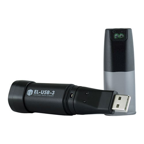

I use thew lascar USB devices for data logging and can certainly recommend them. 32000 bits of data are stored. fastest sample rate is 1/second which gives 8 hours worth. I normally use 1/minute on my wind turbine, which gives me around 21 days.

So here is how it works:
Use a battery, your switch and a voltage data logger. All of these devices should have 2 connections:
Battery: positive and negative. Let's call them B+ and B-
Voltage logger: positive and negative (but does not matter since you are not interested in any values, only if the switch is on or off). Let's call them M+ and M-
Switch: 2 identical connections, let's call them S1 and S2.
Connect B- to M-
Connect B+ to S1
Connect S1 to M+
For gould measure you could add a 1M resistor between M+ and M- but this should be not necessary.
Once you have this setup completed the voltage meter should log 0V for switch open and the battery voltage for switch closed.
Ok. I think I get it know. At least I know what to buy and how to start experimenting. So thank you for that very clear explanation Udo Klein!
