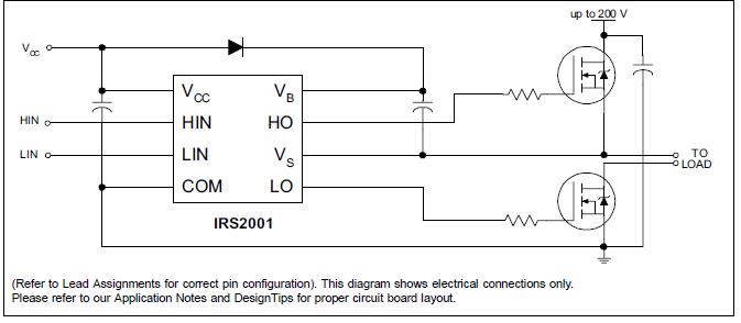

So basically for 1 channel forward, stop, off it would seem all i need is something like IRS2001
2 n channel mosfets 2-3 capacitors and some resistors?
Edit - I added a schematic i found for the IRS2001
i imagine Vcc is the 12v, HIN, LIN the pwm 5v signals from the arduino, COM is the 5v + 12v grounds
what i can't understand though is what is Vb that it only connected through a diode to Vs which is the 12v positive output?
Also seems to me that
HI 0 LOW 0 engine doesn't spin only its positive is connected
HI 1 LOW 0 engine doesn't spin positive connected to ground, engine negative is floating (doesn't seem like a brake)
Hi 0 LOW 1 engine spinning
Hi 1 LOW 1 - things melt.
Did i understand correctly? if so i don't get why go to all this trouble if you only get engine forward and no brake even/
No that's wrong. One terminal of the motor to the mid-point of the half-bridge, the other to ground.
Lin Hin results
0 0 free wheel
1 0 brake
0 1 turn
1 1 MOSFETs explode immediately (not a joke, this is what happens!)
You need to PWM between brake and turn, but with dead-time between - the IRS2001 is
basically much harder to drive than a driver that automatically handles dead-time.
Note that to drive Hin/Lin in antiphase involves either knowledge of programming the ATmega
timer modules, or an external inverter.
I'd suggest ut FAN7380 which is 1/3rd of a FAN7388 basically, does the deadtime. There are
even drivers that have the inverter builtin so take a single input (and enable too).

I have no idea what you said here, do you mean aligning the signals is such a way that only one of the terminals is open at a time, for quick switches between modes?
unless i missed something simple use such as just pwming the high for a couple of seconds, stopping and then pwming the low to brake the engine sound simple enough
I read the schematic wrong. So from what you said i assume the Vcc is 5v input and only the source of the HI mossfet is connected to the higher voltage?
