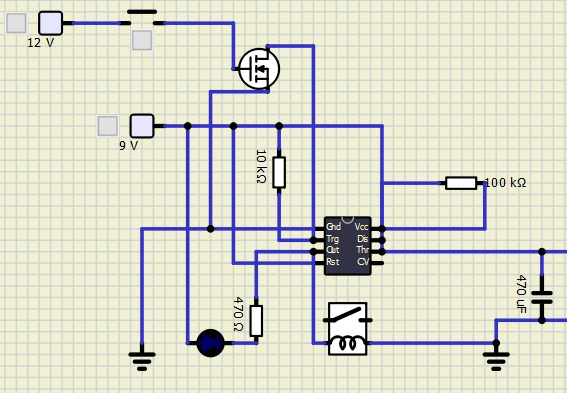

Can you give us a schematic of your circuit? It would help to know what you are doing exactly.
Here is the circuit I made, In this drawing I did change the first relay in the system to a transistor as that is what i was playing around with before i thought of using the arduino to do this.
