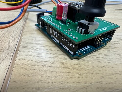

I am trying to use a Stepper Motor, A4988 and Potentiometer Speed Control who was setup
by someone else. The setup was working fine until it was unplugged and left for a few weeks and now since trying to turn it back on, it's not doing anything. I have no copy of the original code that was used.
I've found some basic code from howtomechatronics but I'm not having any luck.

The motor is powered from a 24V external power supply and when everything is turned on, the motor does not react.
Any support or advice would be great, thank you!

@gevo01
Looks like a custom designed motor shield.
Do you have the schematic for it?

It's not the schematic.
I did a search for 22185-stepper driver, came up with nothing.
What you need to do is disassemble everything and use an ohmmeter to see which points on the shield are connected to which Arduino pins.

Your code uses pin 2 as the stepPin, as does the diagram in post #4.
However looking at the photos of your 22185- Stepper Driver PCB, I can see that pin 2 doesn't seem to be used.
 ![22185 Stepper Driver](https://europe1.discourse-cdn.com/arduino/original/4X/0/7/4/074737ed31409410bb654c17672b837f658d3fea.jpeg)
I can see connections from Arduino digital pins 4, 5, and 7 going towards the daughter board.
You need to check which pins they connect to on the plug in driver board, and then adjust the code accordingly.

![A4988 connections](https://europe1.discourse-cdn.com/arduino/original/4X/6/3/f/63f97c58961f9acb0fd36f2e59165f652719a067.png)
![STEP 4 DIR 5 ENABLE 7](https://europe1.discourse-cdn.com/arduino/original/4X/c/9/5/c95dcd4a6f6a7312f122b3c1a262007f78ca54c2.jpeg)
Looking at the A4988 connection diagram that I found at [https://www.pololu.com/product/2128](https://www.pololu.com/product/2128) , together with your photos, it looks to me as though Arduino digital pin 4 is connected to the step pin.
(Arduino digital pin 5 looks as though it is connected to the dir pin, which is what the code expects.)
Check whether that is the case.
If it is then you need to change
```arduino
#define stepPin 2
to
```arduino
`#define stepPin 4`
EDIT:
Annotated photo added.
Now that I have seen the new photo that you included in post #9, I can see that pin 7 goes to the !ENABLE pin on the A4988 driver board.
Pin 7 needs to be taken low to enable the stepper motor driver.

Try this modified code, which takes pin 7 low to enable the A4988 driver, and uses pin 4 for the stepPin.

Perfect, thanks that's solved it and is now working!!
The potentiometer is controlling the speed, however, it's only rotating a few degrees and not doing a full rotation.
Is there a lot of work involved with modifying the code to make it rotate to a certain position then stop?

These are the wires to the coils.
 ![image](https://europe1.discourse-cdn.com/arduino/original/4X/e/d/1/ed16c7a531bee48046cd30dc487efe739fe817bd.png)
 ![Image (7)](https://europe1.discourse-cdn.com/arduino/original/4X/4/b/e/4be5d4eec9d3a7ae8d2ef696cb84be105d038871.jpeg)

A and B define the pairs, so orange and blue should both be B say. As you have it they're connected to different coils.
