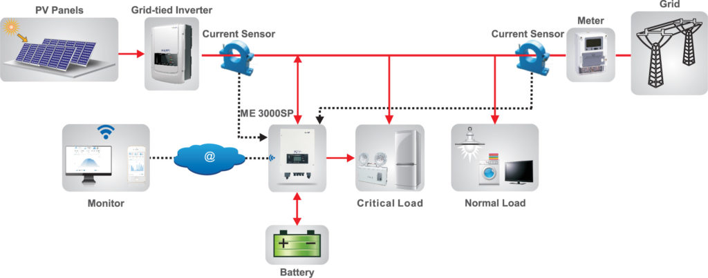

I want to install a battery storage for my house. It needs 2x CT clamps to measure PV generation + consumption to limit charge/discharge rate. Unfortunately I can't route CT clamps - so looking if I can cheat the system and pretend to have a CT clamp installed.
Here is a CT clamp I need to simulate: OPCT10AL
It outputs CURRENT (3000x less than on input) - is there a way to simulate this with arduino?

Sorry for not making it clear in the first place:
I want to install batteries on AC side (so can charge it from AC when electricity is cheap at night and from solar PV).
This requires use of CT clamps as on this image:
As clamps output current (not voltage) I suspect I might need an inverter circuit to convert DC to AC: http://www.theorycircuit.com/arduino-inverter-circuit/ - would this work? is this the simplest solution?

Hi Tom. Routing CT clamps would require a lot of drilling, and even then would not be perfect as I have two separate solar arrays with two inverters in separate locations. I'm software engineer by trade - so programming arduino or esp8266 is an easy part for me. I already have a home automation system that collects data in real-time from both solar pv inverters and consumption data from "Network OWL" device - all is pushed via UDP broadcasts into rapberry pi.
What I want to achieve is to be able to control battery storage with my own code (charge when surplus PV is available, or at night when electricity is cheap, most likely take into account weather forecast). Software part is easy - but I'm having problems finding a decent hardware that I can control.
Essentially all battery storage systems use CT clamps - so I'm hopping for relatively easy way to "hack" the system and replace CT input with my hardware+software. One system that is of good price is this one
This system is using CT clamps that output current (voltage would be much easier!) - so I'm exploring if it's possible to "simulate" such CT clamp, and when connected to the battery charger/inverter to tell it that either there is spare PV, or that it should start discharge. It would be much better to have like RS232 interface to be able to control it (no it does not, already asked the vendor).
My own research point to DC to AC circuit needed: http://www.theorycircuit.com/arduino-inverter-circuit/. I wonder if you guys have comments/ideas/show stoppers here (I'm not electrical engineer so better to ask first :)).

I think we did, he wants to make a simulation of the two CT in this diagram.
@irekz hasn't addressed is if he/she gets the arduinos to simulate each of the CTs, how will he/she know what magnitude current to simulate.
@irekz wants to control the operation of his system, and using CTs measuring real time currents is the only way to do it.
