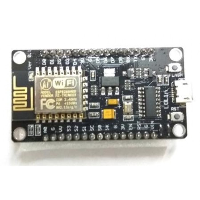

Hey I am a begnner..!!! And I have the same issue.. Please help my esp8266 wifi module don't have 5v.. So I don't know how to do the 5volt part..
Hey! I am beginner and I have the same problem.. There is no 5volt in my esp8266 so I don;t know how to do this 5volt part.. Kindly Help I am stuck in this since last week... I have tried all the things but can't get the solution... Here is my esp8266 wifi module..
Thanks in advance!!!
That appears to be a NodeMCU. How are you providing power to it? Are you feeding 5 V to it by the micro USB jack? If so, your (almost) 5 V is appearing on the "Vin" pin, so you connect your relay "VCC" to it.
If you are not feeding 5 V to it from a "phone charger" or similar by the micro USB jack, how on earth are you powering it?
