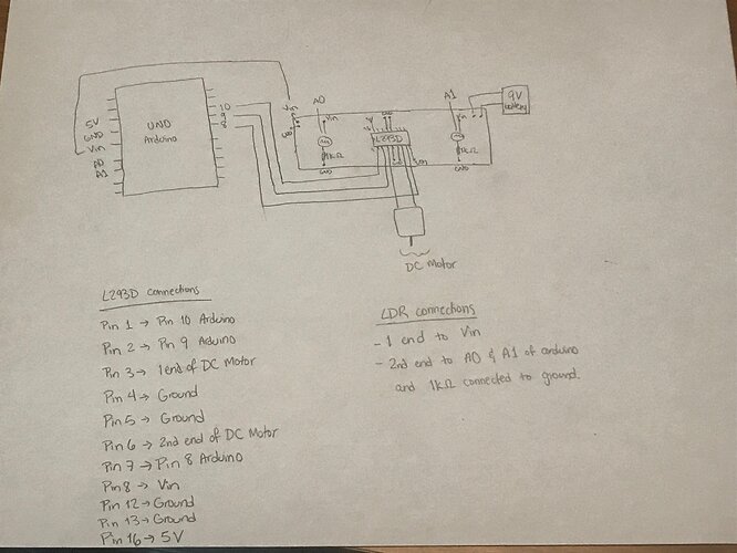

Hi all,
I'm relatively new to Arduino and I'm working on a project with solar energy. I'm trying to create a single axis solar tracker using a DC motor and LDRs. The way my code works is by comparing the voltages of the LDRs and the motor follows the LDR with more light. As of now, the DC motor follows the LDR with more light hitting on it, but I would like the motor to rotate at certain angles instead of continuously rotate and I don't know how to achieve this. Please help if you can!
Here is the code:

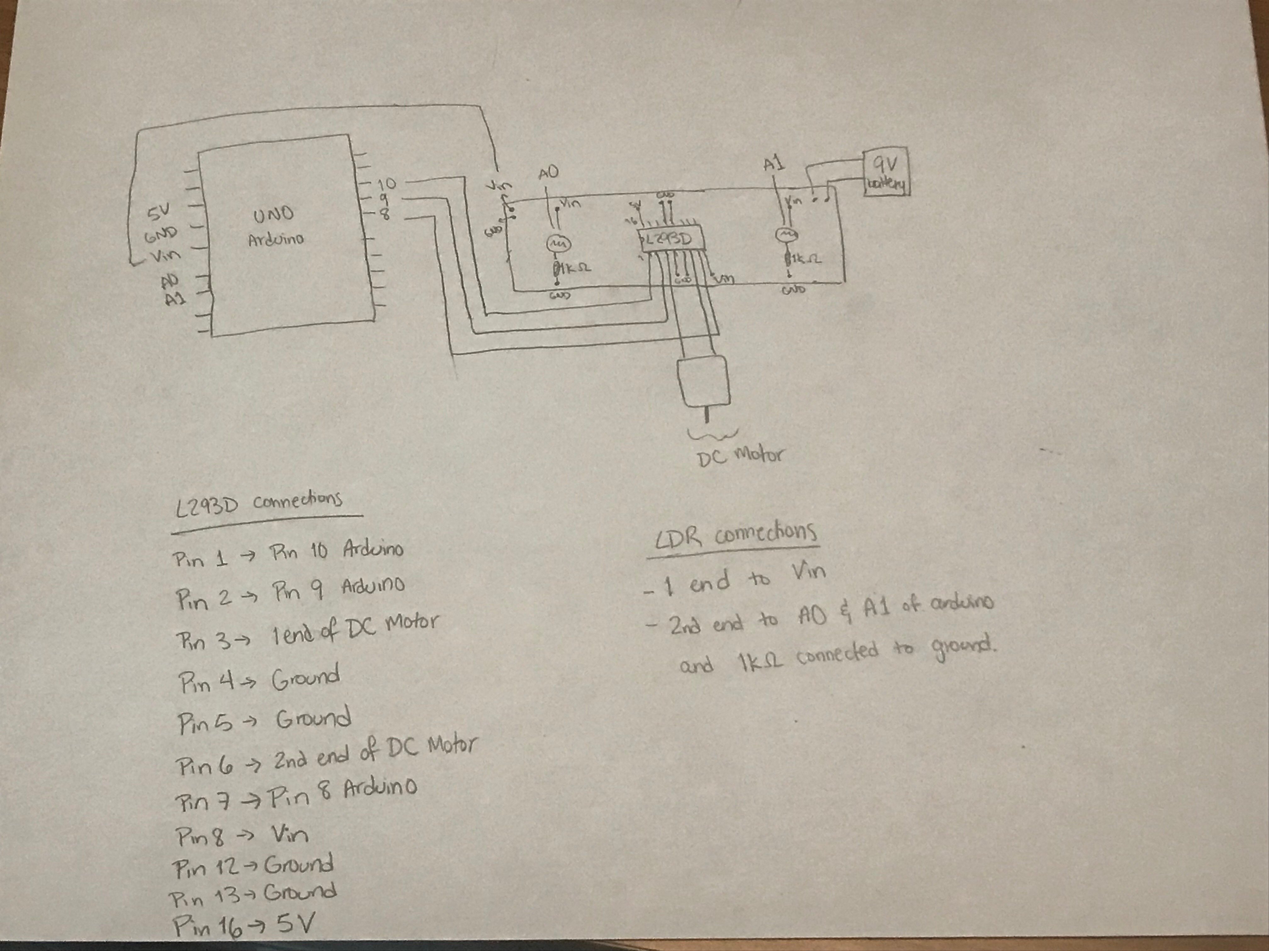

Attached is the picture of the circuit I'm using.
