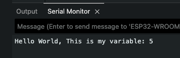

Try this.
template<class T> inline Print &operator<<(Print &Outport, T str) {
  Outport.print(str);
  return Outport;
Serial << "Hello World, " << "This is my variable: " << 5 << "\n";
It will work for any Arduino
I use printf all the time but mostly just concatenate. Maybe I am missing your point.
