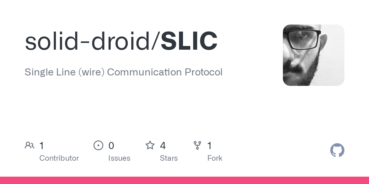

Hey guys, I build this library called SLIC for inter-micro controller communication over a single wire.
SLIC is a single line(/wire) hardware independent half duplex asynchronous communication protocol.
By hardware independent I meant, its purely software based and you could theoretically run this on any GPIO pin.
This basically solves 2 problems:
  1. Now inter-micro controller communication is possible for all those cheep micro-controllers with no inbuilt dedicated hardware setup for communication.
  2. It just uses a single wire and could interface multiple nodes with that wire..(like I2C)
I wish to hear your opinion about the same...
You can find the library here:
