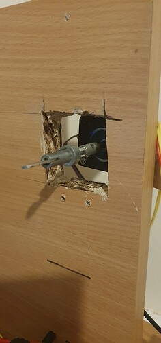

The spool of string module has a magnet on the bottom.
The motor has a washer slightly indented into a well in a disc.
The spool’s magnet inserts into the motor well.
The magnet is free slip on the washer if need be.
The power of the magnet keeps things coupled.
Ignore the wooden module on the left, this module is locked in place with its magnet.

I’m sure you can come up with a solution using magnets.
A spacer between the magnet and washer can adjust slippage strength.
There are many different shapes and sizes available: discs, rods donuts, balls etc.
