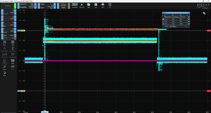

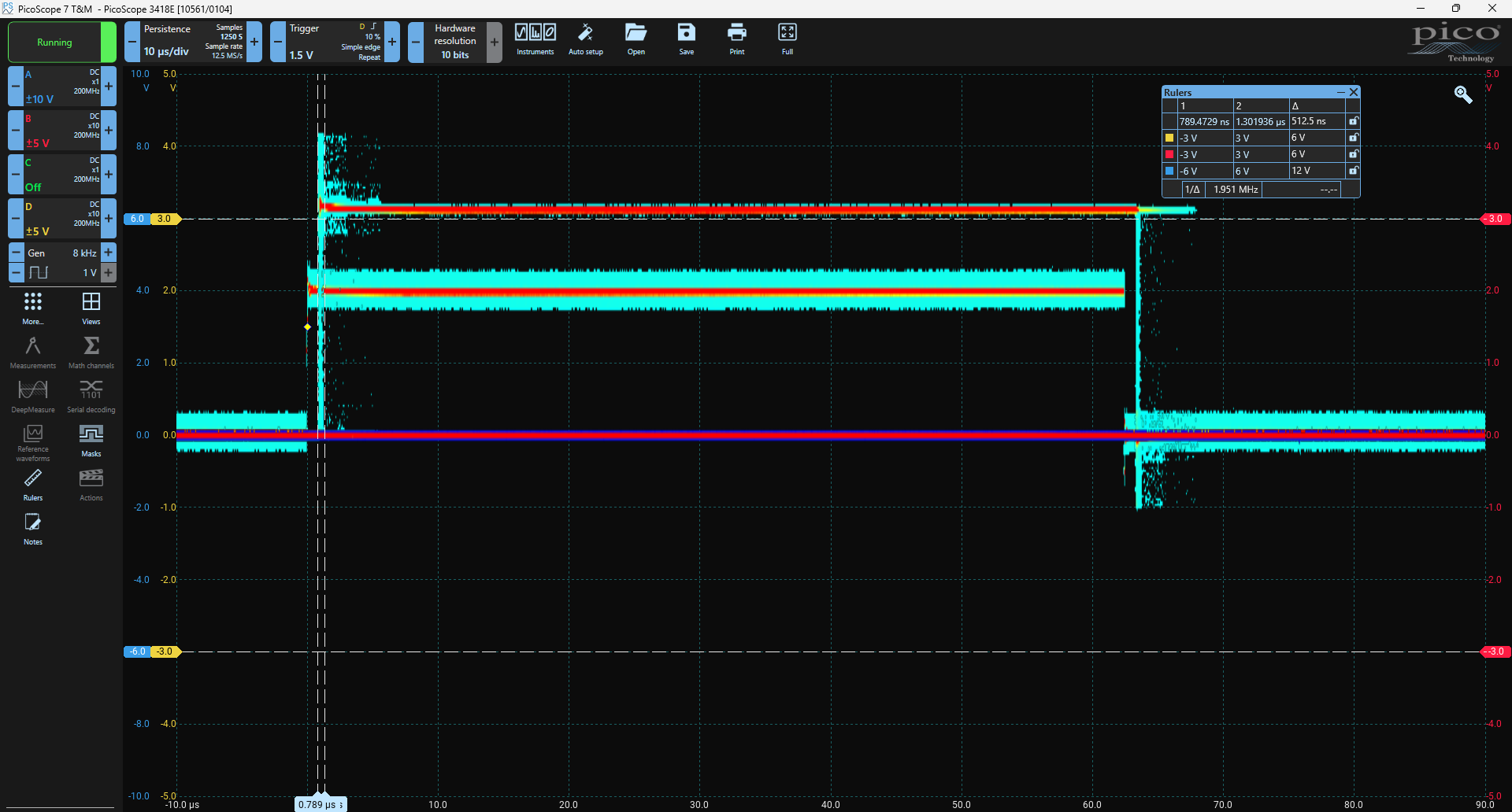

I purchased the H7 Portenta Lite recently and was very surprised about the jitter and the slow speed of the interrupt detection. Following scenario:
I have connected an 8Khz rectangle signal to the PH_15 Pin. Based on the rising or falling edge I am setting the PA_8 either high or low. When I look at the 8Khz Signal and the output of PA_8, PA_8 needs around 1us to be set to High and around 1us again to go to low.
Further, there is around 100-300ns jitter on the output of PA_8.
I expected much higher speeds due to the 480Mhz or 240MHz clock. Is there a way to speed up the detection process or minimize the jitter?

Thanks for your answer, but my main concern was the time it takes for PA_8 (red in the first image) to switch from low to high after the Interrupt which was caused by the rectange signal connected to PH_15 (yellow in the first image). It takes around 1us to detect the interrupt and switch PA_8 to High. I was assuming that this should only take few clock cycles? Can anyone do this faster or achieve few clock cycles?
Thanks a lot
