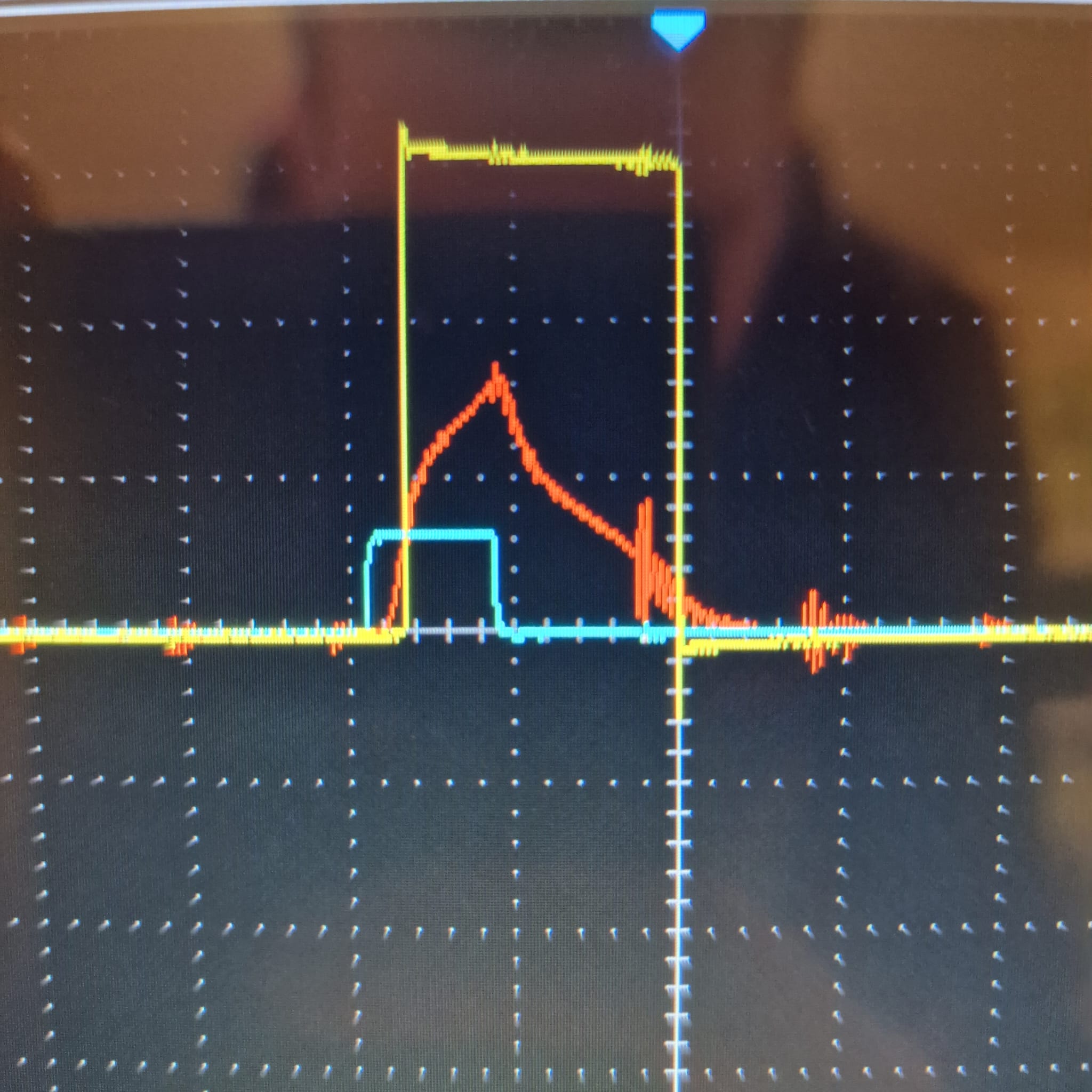

I am using two optocouplers(BL817) to turn on and off a TC4427 mosfet driver. The driver's input capacitance is 12pF. I am using one optocoupler to connect the input to 15v, and the other one to connect to GND.
Blue is input signal (50kHz PWM)
Red is mosfet driver input
Yellow is mosfet driver output
As you can see the output is quite different to the input signal.
Actually I am trying to switch a N channel mosfet on the high side at 50kHz, using a DC-DC isolated converter, and I just don't know how to do it correctly. I am powering the mosfet driver with the DC-DC, and using the optocouplers to isolate the driver input from the rest of the circuit.
Any suggestions?
Thanks!

It looks something like this
Are there any resistors to show?
And a mosfet maybe?
100ohm on the inputs of opto's.
And what is driving the "slow" optocoupler ?
At the moment two more mosfet drivers, one of them inverting, as my mcu can output only 6mA.
Please take the time to complete the schematic
So you hava a mcu driving a mosfet driving an opto coupler driving a mosfet?
Doesnt matter what drives my opto's. The mosfet drivers driving the opto's is only because my mcu can only output 6mA. I can use a wavegen and it doesn't make a difference. The signal driving opto's is 1.2V, beautiful and same-looking as the input PWM signal.

U3 serves no function in this schematic. The optos are digital, not analog. You got a clean switch to a soggy input, what is problem? Yellow trace is following blue cleanly. What were you expecting?

There is your major problem. 1.2 V is not sufficient to drive the optocoupler. Inside it has a LED. This LED will not give any light below 2V (depending on LED type).
It seems it does matter what drives the optos..
What you see in the graphs is a very tiny current through the optocouplers charging and discharging the capacitance of the mosfet on the input side of your mosfet driver.

The LED inside an opto couler typically drops 1.2volt, because it's infrared.
I assume OP has a 3.3volt processor, and a series resistor that limits LED current to about 5mA.
That resistor, and it's value, should have been on the diagram. 330ohm would be a good value.
Note that common opto couplers are saturated switched, and therefore slow.

Rise time 4µs. Fall time 3µs. 6N137 is mutch faster rise time 24ns and fall time 10ns. Needs only 5mA.
Why 2 opto? 10k between VDD and INA. If U1 is on, OUTA = low. If U1 is off, OUTA is high.
