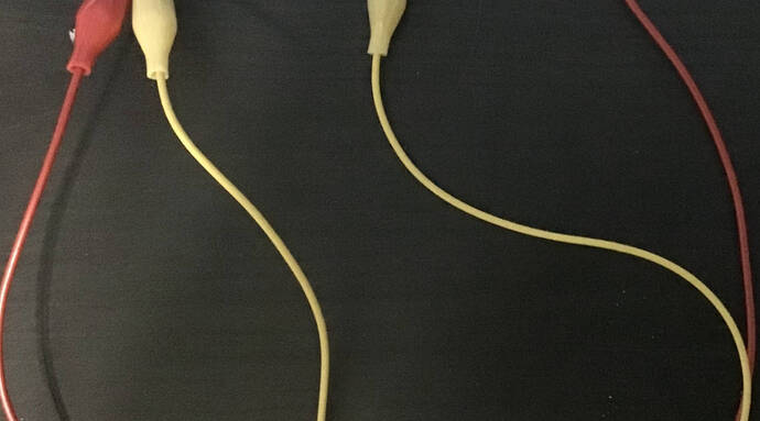

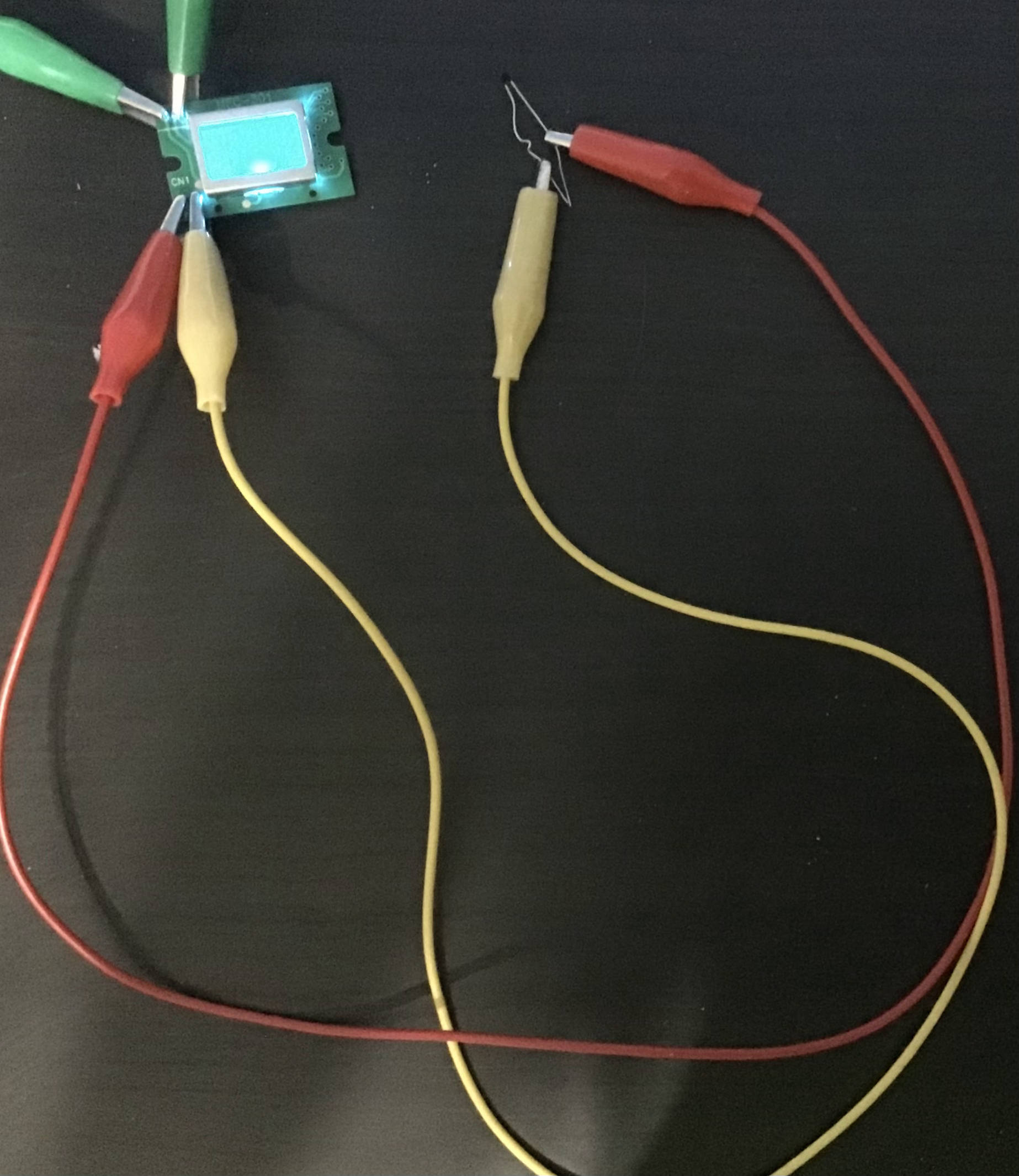

I connect the thermistor to the brown connector on each side, but It wasn't showing temperature. It was showing nothing but blank. The backlight was on but It didn't read Fahrenheit for Celsius. It was blank, maybe because that not a pin that measure temperature, it might be a data input or a signal input.
Here's the picture of the project.
The two green alligator clips connects to power connection and the red and yellow alligator clips connect from the TH connection to the thermistor as shown.

Did you check with a potentiometer instead of a thermistor?
Also, check if one of the TH pins is directly connected to GND. If it is, try to apply small voltage to the other pin - you can try using a potentiometer connected as voltage divider to the two TH pins and the + pin.
