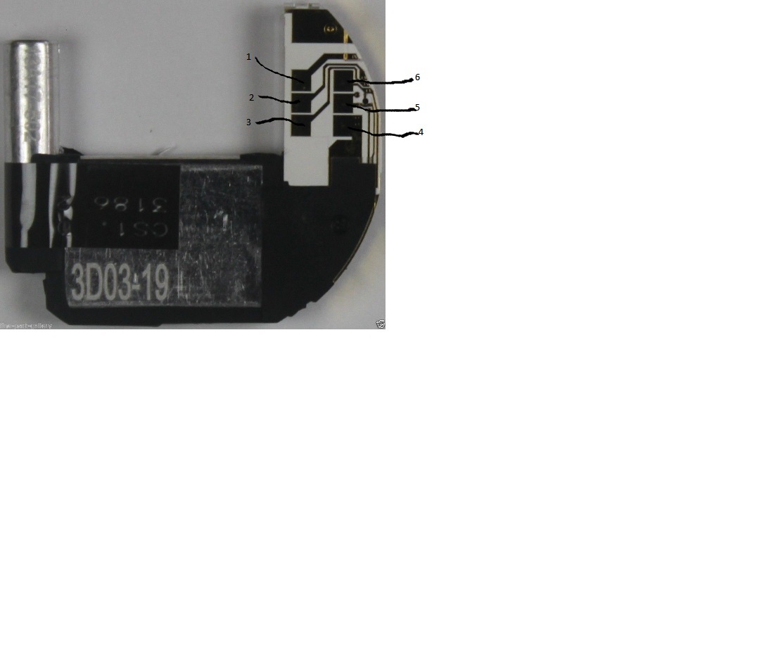

Small xenon flash
The camera should be arriving soon, but I've just ordered the flash, so it might take a while.

See attatchment.
I suspect from the size that 1 and 4 are power connections.
2 and 3 i suspect are trigger via an opto isolator.
4 and 5 being start charge input and charged output.
Seeing the circuit would help , getting the supply right and correct polarity is the most important bit.
Poking around with a dmm after that should be fairly safe way of sorting out whats what
Do these modules also include a focus assist LED as this would account for one of the contacts.
The flash in the Lumia 1020 is controlled over I2C-bus and triggered with a GPIO-pin.
If you have a working phone you can sniff the communication that tells the module to power on etc.
Without that, not much doing unfortunately :frowning:
Be warned that the I2C-bus is probably one that works at 1.8V, 2.5V or the like.

Thats annoying.
At least we know the pinout though.
Yeah, that's not very good news.
Fortunately it's not a proprietary protocol.
Unfortunately I don't have a phone or a logic analyzer. Now at least I have a good reason to buy the latter, and I suppose I'll manage to do something about the former.

You will need the phone to find out what commands it sends to the flash. Trying to get it working without the phone will be an exercise in futility.

You are correct. But you will never get that kind of information. I have been at Nokia HQ in Denmark a few years ago. Documentation is kept well secret to not help out competitors. There is a reason that all service manuals is obtained via "grey" channels.
