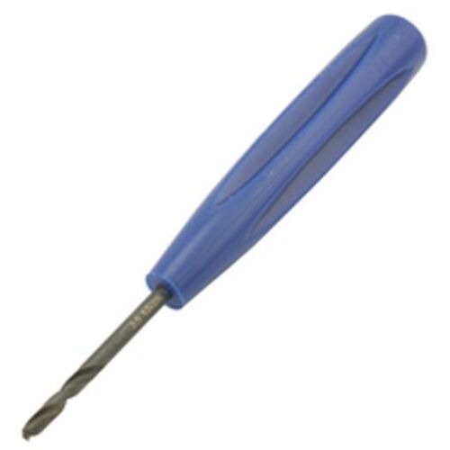

I would look at Pro Mini, Nano 3 or Pro Micro on stripboard or tripad board. You can even get premade pcb laid out just like a solderless breadboard so you can transfer your components accross to the same positions.
http://www.ebay.co.uk/itm/STRIP-BOARD-VERO-BOARD-VARIOUS-SIZES-AMOUNTS-1X-4X-10X-/140900074333
http://www.ebay.co.uk/itm/Copper-Prototype-PCB-Stripboard-Printed-Circuit-Board-Strip-Vero-Board-/180987701576
http://www.ebay.co.uk/itm/Copper-Prototype-PCB-Stripboard-Printed-Circuit-Board-Strip-Vero-Board-/200703302283
http://www.ebay.co.uk/itm/Copper-Prototype-PCB-Stripboard-Printed-Circuit-Board-Strip-Vero-Board-/170860932701
Some things to bear in mind: powering your project - Pro Mini etc. tend to have lower capacity regulators than Uno.
Off-board connectors need to be strengthened or made detacheable. One way is to use screw headers, or for permanent soldering, use a dremel and very fine bit to widen holes so that you can weave unstripped wires through before stripping the end to solder through an unwidened hole.
