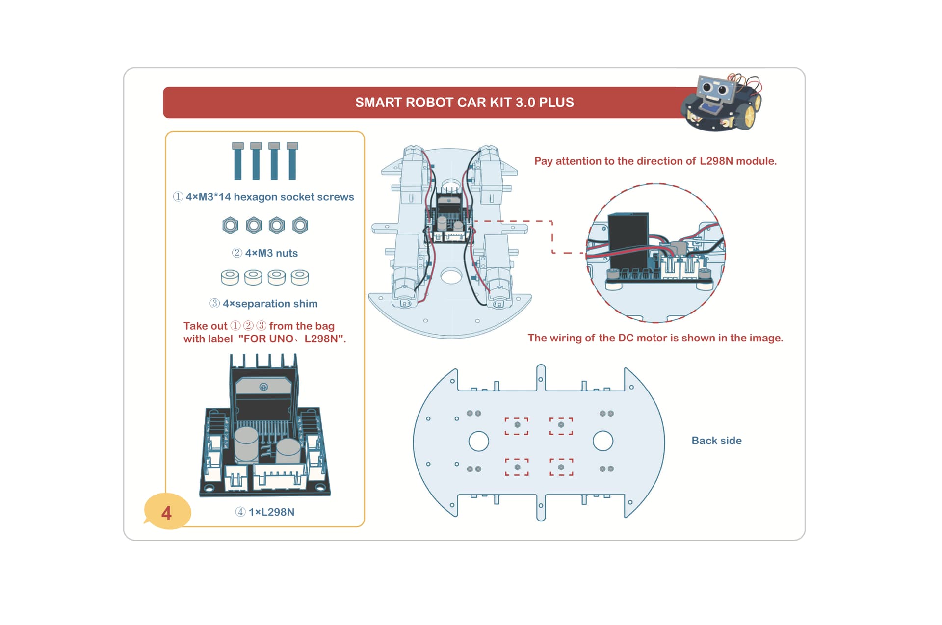

I recently put together the Elegoo Smart robot car v3 plus. I've had a couple issue. Firstly - the wheels apparently turn opposite to the direction they are supposed to turn. For example, selecting on either the bluetooth BLE app, or the infrared remote to go Forward, the car spins right. I triple checked that the motors are installed as instructed and wiring is as instructed. So I downloaded the arduino IDE and loaded the obstacle avoidance sketch and of course it didn't work correctly because all the motion instructions (fwd, back, left, right), were wrong. So I updated the forward(), back(), left() and right() to reverse the HIGH/LOW definitions and uploaded the sketch and it worked. And comments on why everything is reversed?

OK, I figured out how to re-load the original sketch that came with the unit from the download files. Program is called SmartCar_Core I then updated it to use the correct combinations of LOW and HIGH feeding the wheel motors to make it turn left, right, forward, backward properly. I can only assume there is a polarity reversal on the wiring to the motors but now I have a work around

Care to share the wiring diagram you were originally following? :face_with_raised_eyebrow:
I followed the diagram in the assembly instruction book. (attached).
OK, and you have the same connectors as the diagram with red and black wires and you connected the top and bottom wires to the motors with the colours as shown?

Did you follow the "pay attention to the direction of L298 module" advice?
Have all the motors got the same plug on them, wired exactly the same way?

Thank you all for your responses. The way the plug is keyed I believe it will only go in one way and it does appear to me to agree with the color (red/black) in the instructions. I've attached pictures. The orientation of the L298 module is correct.
The motors are clearly installed so that the same voltage polarity on right and left motors, would cause them to rotate in opposite directions, from the point of view of the vehicle frame.
Which is why the diagram indicates alternate motors wired with alternate polarity.
