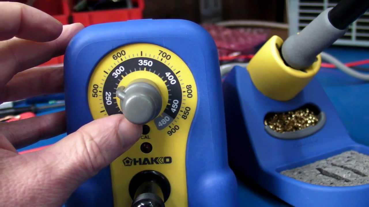

I want to create a small PCB using only smd components, smd atmega, smd regulator everything smd, just a simple example to master my skills in smd soldering and making pcb, i had this question for many months maybe years, how exactly to solder smd components and how hard is it.
I've seen many youtube videos and there is many tehnics how to solder smd components but for that it require many different tools (hotgun, oven, solder paste..etc), as a beginner i got only the basic soldering tools.
Any advice as a beginner in smd soldering? I want to master my skills and create more complex
smd PCB's in the future making my projects small as possible as well saving as much as possible space
while creating a device.

Do it right. Get a laser cut mylar stencil from pololu.com for applying solder paste.
Get an old 4 element toaster oven (basement or a yard sale) - want 1500 watts.
Get a multimeter with thermocouple probe.
Use the stencil and plastic putty knife to apply paste. Place the parts.
Put in toaster oven, crank heat to 125C, hold there for 90 seconds, crank heat to 195-200C, hold there for 90 seconds, let it cool down. Try a few runs to see where you need to turn your heat dial to for the temps. May have to dial it back & forth a little while holding to keep it near the desired temp.

For making just a couple of boards, drag soldering really isn't that bad.....
Tack the parts in place by one pin, no clean gel flux along the other pins, drag solder... it's faster than soldering a DIP with as many pins ime.
