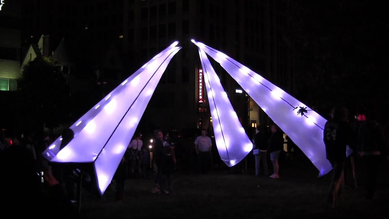

Here's a vid of a project I had where all these things worked before:
