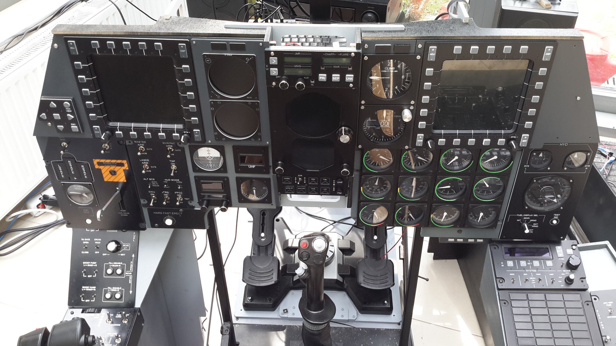

All, I have an OLED display which shows the numerical output from a computer program, which gives values ranging from 0 to 65535. It is supposed to be a linear progression, however the OLED shows that there is some erratic noise being injected somewhere, which causes the numbers to corrupt for a split second.
In itself the noise is not an issue for most of the time, as it is used for a signal to a stepper motor driving a pointer representing an altimeter gauge, however the OLED display is supposed to represent the digital version of the gauge and it flickers and jumps, an annoyance.
Is there a way of smoothing the signal within the arduino sketch?

The intent is to use the output from a program called DCS BIOS, which reads in game data from DCS World aircraft simulator in order to output a stream of data to an Arduino that can be used to drive stepper motors for gauges, LCD displays, OLED displays, LED's TFT's, etc in order to simulate real world gauges. Here's the site if you are interested
http://dcs-bios.a10c.de/
The problem is that I have no way of getting in between the signal from the PC and the Arduino, as it is a direct USB connection
I've attached a picture of the cockpit I'm building, and here you can see the effect https://youtu.be/xn44cSU3Gfc
the OLED number is glitching as it is able to display the numbers faster than the LCD
And here is the effect it has on the Altimeter when it is working (about 30 seconds in)
If I can smooth the signal that is being used by the Arduino to output the number to the OLED, I am hoping it will cure the glitching
Apologies for not being super informed on how it works, DSC BIOS was written by some clever guys for us to be able to use for stuff like this, but it was an amateur project and I believe development on it has stopped, so we have what we have. Engineers like me can use it as they generally made it simple to incorporate, but when it has issues we struggle.
It is easy enough though that most of the gauges and displays you see in the picture actually work

All, another guy with the same problem as me has been helping with this, and we have been doing some more in depth testing.
We now believe that the output from the DCS bios program is stable and correct, and that whatever is happening to the display is a result of how the sketches process the data or the interaction between the sketch and the OLED devices.
We did a battery of tests to try and isolate where the source of the glitching could be, after trying various things including trying to average the signal. One point that appeared was that we noticed the OLED display glitching even when the signal was static.
The unstable output appears to be a false lead, as when multiple instances of the same display device are put in, both reading the same output signal, they behave differently and display different data.
One was moved from a Nano to a Mega to see if it was memory issues, but it made no difference.
As a result we are forced to conclude that the glitch resides somewhere in the sketches, and not with the output from DCS Bios

Well, we (I say we, I actually mean a clever chap in Sweden) resolved it. I said I would report it here if we did.
It was indeed a data issue, changing the following line
#define DCSBIOS_DEFAULT_SERIAL
to
#define DCSBIOS_IRQ_SERIAL
basically cleaned it up. The explanation given was that "using DCSBIOS_DEFAULT_SERIAL will work on the vast majority of Arduino-compatible boards, but you can get corrupted data if you have too many or too slow outputs (e.g. when you have multiple character displays), because the receive buffer can fill up if the sketch spends too much time updating them.
If you can, use the IRQ Serial connection instead."
So we have smooth data flow and OLED displays now
