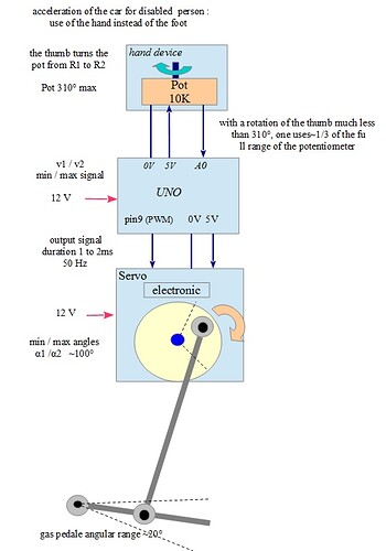

  • My first application with Arduino is a servomotor driven by a UNO card. One of the analog inputs is driven by a potentiometer. Then the voltages corresponding to the resistor values will be used to modify the angular positions of the output shaft Let's say R1 correspond to alfa 1 and R2 correspond to alfa 2.
  • The software ( found in the literature) uses the following instructions ( loop section )
val = analogRead(analogpin) ;
val = map(val,120,50010,60) ; // R1 > alfa1 =10°, R2 > alfa2 = 60°
myservo.write (val) ;
delay (100);
This is clear, I understand the logic but it seems to me that the code is not dependant of the characteristics of the servomotor ( as hardware) such duration of pulses for a given angle, frequency, reference angle etc . Are they standard values all included then in the library servo.h ?
Thanks in advance

Thanks to both of you, but my question is not may be crystal clear :
  • Starting from the fact that the potentiometer value will varie from R1 to R2 ( and not from 0 to Rx ), it should idealy correspond to min/max values of alfa such alfa1/alfa2 (output) . The total angular variation expected shall be ~100°.
    So I understand that I need first to select the proper servomotor covering this range and mechanicaly set the servo such that alfa1 is close to the position zero of it ( to be sure that alfa2 will be inside the servo range).
    If now if I use « writeMicrosecond( ) » I need to get the data pulse duration( angle) from the manufacturer or perform the measurements (calibration).
  • Now concerning the map instruction, knowing that potentiometer min/max values are R1/R2, the gain of the system shall be (alfa2-alfa1) / (R2-R1)
    If I use « val = map(val,0,1023,10,60) ; » I do not see how R1 will be associated to"0" and R2 to "1023" value or the gain will be lower ?
Note : I don't have yet the sermotor to make tests and try to have a good understanding of the instructions first...

OHHH this for a throttle positioning system on a car...
You will need to be very careful because of safety requirements, is this for a road going registered car?
There may be certain design rules that you may need to follow.
Positon R1 = 10deg of 310deg = (10/310) x 1023 = 33 from the AtoD.
Positon R2 = 60deg of 310deg = (60/310) x 1023 = 198 from the AtoD.
If the pot is outside R1 and R2 what do you want the servo to do?
Stay at the max or min value of R1 or R2?
Until you get your servo and fit it to get your output angles, we can only suggest a method.
But please check in on the legalities of what you are doing if car is registered for the road.

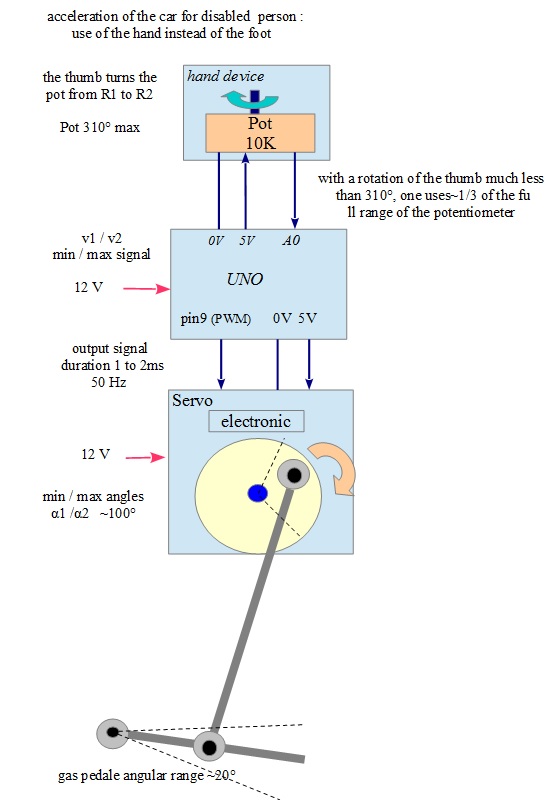

Image from Reply #9 so we don't have to download it. See this Image Guide
...R
