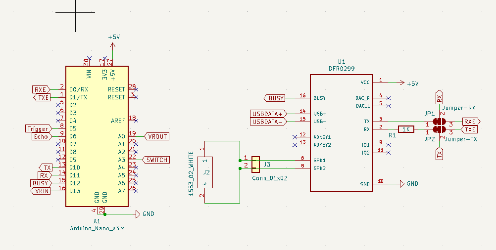

Working Schematic

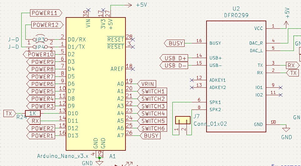

Non Working Schematic

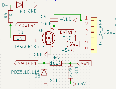

On the non working version, every input/output is as per this
(I haven't uploaded the whole schematic as it's quite big and not a lot of it is relevant).

So... @david_2018 mentioned about interrupts. I checked which pins the Nano used for interrupts (D2 and D3), found that whilst I had mosfets connected to those pins (via resistors, of course), they weren't actually then doing anything on this application, so removed the resistor, and hey presto, suddenly it will talk to the DFR.
Certainly a step in the right direction. However, now 2 of the outputs don't illuminate and it completely ignores all of the inputs....
So. I think, "Hey, what if I swap out the two suddenly not working outputs for two spare outputs, and remove those resistors too"...... And it worked!!
So. TLDR, if you are trying to use software serial (on pins 10 and 11), you CANNOT have anything connected to pins 2,3,9 and 12.
As the problem is solved, I only skimmed the thread, so maybe I’ve misunderstood. But that general warning surely cannot be right? I’m certain I’ve used one or more of those pins in my many DFR Player projects, as well as 10/11 for Rx/Tx.
Pin D12 may or may not be relevant tbh, I’ve later realised that I do have that one connected to the busy pin on the dfr299 on other projects. But pin 9 I’m sure is an issue, as the led I had connected as an indicator on that output always had a low glow to it, suggesting it is doing something. I don’t know if I had simply disconnected pin 9 whether pin 12 would have then worked ok, but whilst pin 9 was not floating, pin 12 would not output.
