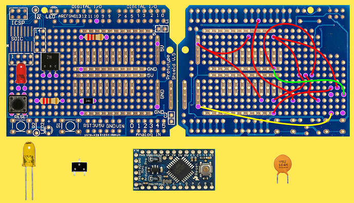

Pencil and paper works too. For example:
Use your graphics program, then for components copy images from the internet.
I use ExpressPCB to layout parts on boards, and a schematic for the wiring. I don't find showing the actual wires all that useful for hand wiring.
Here U1 is a Promini.
Board is a 80mm x 100mm Island of Holes board from Velleman, very good quality, and turns out to be the same size as the Free version of Eagle CAD software.
Later versions of this board I used a '328P with crystal, caps, reset pullup resistor, and offboard 5V power supply.
This maybe what you are looking for. it will do the layout you posted
