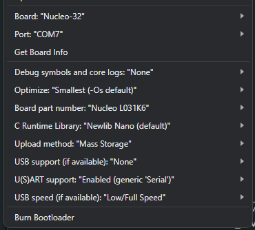

I use Arduino IDE and "STM32 MCU based boards" to program Nucleo32. Here are the settings:
I connect it directly to computer using USB.
