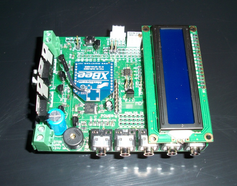

Hi, I've designed a shield to go with the Arduino MEGA as part of a solar-tracker product I'm launching.

Here's the features for v.2 of the board:
  • 100 x 80 mm dimensions (same width as LCD)
  • 5, 3.5mm (1/8") stereo jacks for i/o: 4 analog, 1 digital
  • configurable pull-up and de-couple caps on each analog line
  • cpu input pins sense plug insertion into jacks
  • 16 pin header for standard 16x2 LCD module
  • pwm control of LCD backlight
  • 8 pin header for matrix keypad
  • XBee socket
  • XBee configurable for COM0 or COM3
  • RJ45 ports for 2 single channel H-Bridge motor controllers
  • header for a third motor controller
  • 2 pulse inputs attached to interrupt capable pins (2,3) associated with motor ports
  • piezo buzzer
  • MCP7940 RTC with alarm (tied to pin 19, also interrupt capable)and battery backup so your arduino can wake itself up
  • on board temp measurement with thermistor circuit
  • pwm control of Aref with single pole R/C filter.
  • 2 panel led connections
  • extra I2C and serial port breakouts.
My goal was a board capable of sensing time and environment and controlling actuators, relays, and other such things needed for solar energy related process such as a single axis-solar tracker(polar or azimuth) or temperature differential control system.
I've attached a picture of the first version of the board. The guys at iteadStudio made the first pcb's for me, which incorporated a simple discrete component based single H-bridge circuit using TIP-12x Darlingtons. I quickly learned how it can short out on the USB connector, felt stupid, and decided to move the motor driver off board. The new version will have pin headers as well as standard RJ-45 jacks for motor driver connections.
I also incorporated a LM75 temperature sensor into the first version, but still haven't gotten it work. Since the RTC is also on the same I2C bus and it works, I'm not sure what's up. I decided to toss the LM75 and put a thermistor on the board instead for version 2.
I've got a few extra prototype boards I'm willing to sell (can you sense the attachment?) that have the H-bridge circuit. Like I said about the LM75, I'm not sure if that works, but everything else checks out. I'll have my new website ready this weekend to handle transactions with PayPal and post a link for that. Send me a message now though if you think you are interested.
Thanks for reading, and I appreciate any feedback.
Assuming that this unit is going to be outside, those 3.5 mm sockets will probably corrode and allow ingress of moisture.
I would review all your external connections to ensure that cables connect inside the box (terminal strips?)after coming through a watertight gland (or grommet) or go down the expensive path of using IP rated connectors.
It seems like all the fancy waterproof connectors cost as much for a working male/female pair as an Arduino, or more, so I decided to go with a sealed enclosure with room for connections and waterproof fittings. The only way that seemed practical in the end, and that allowed me to have 5 A/D fully bucked IO ports was the 3.5mm jacks, but I knew they had to be protected since any type of normal jack that plugs are commonly available for could let moisture get to the electronics.
Here's a picture of the controller in it's enclosure. Some may recognize it as a polycarbonate waterproof box for kayaking, etc. made by Outdoor Products. The membrane keypad overlay is designed for exposure and allows user control without opening the case. Double latches and a gasketed seal keep the door water tight, and I drill out for a watertight conduit fitting. I use 3/4" near the control unit, and then switch to 1/2" for the branch lines (motor, power, sensor, etc.). There's enough room in the box to make all necessary connections, and a packet of silica gel prevents condensation. I like using neoprene rubber stoppers for grommets in the end of the conduit body where any final connections are made before going out into the weather. The stoppers get drilled out appropriately and then the wire is sealed with silicone. Flex conduit and regular pvc conduit are so cheap, it seems like a no brainer to protect as much of everything as possible, and it makes it look nice too.
