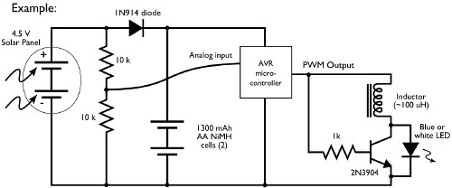

I was checking out this simple circuit, as for the QX IC it doesn't require a light sensor/LDR and it could help on saving battery life blinking the LED or checking activation hours vs a RTC.

SeaWalker:
Yup...that's a cute circuit, and it looks like it might actually work --- BUT, the missing piece is [as said before], if you plan to use lithium chemistry batteries, you have to manage them properly, or you will damage them and/or cause a fire. You might get away with using the AVR µC [plus support circuitry] to manage the batteries, but you should know what you're doing.
Some battery chemistries are damaged by deep discharge -- Li being one. So, some sort of battery level detection should be added, with, a routine to not only turn off the PWM output, but also, to put the µC to sleep [with something like a periodic watchdog timer wake-up that runs a test of the battery voltage and decides whether to go back to sleep, or stay awake (this can be done on a PIC µC, but I haven't investigated AVR µCs for this sort of thing)].
Also important is to not over-charge, or charge too rapidly, the batteries [also a chemistry dependant thing -- but ESPECIALLY IMPORTANT for Li chemistry!]. Unless the Solar array's internal resistance and power output is perfectly balanced to the charging needs of the batteries-of-choice [which is unlikely because of the variability of solar power], a mere diode is inadequate for most charging scenarios. NiCads are more forgiving, in this respect--but it's still important to not over charge, or "trickle-charge" at too high a current.
ReverseEMF:
I plan to let the AVR sleep and use the two resistors in parallel to the solar panel to generate an interrupt to wake up the uC.
Can I use this small circuit? It is designed for Li-ion and seems to have low-voltage cutoff too.
