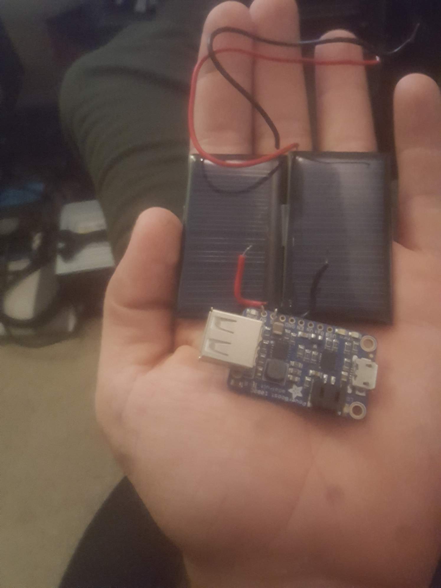

I don't believe you need an Arduino depending on what you are trying to do. If you are using the solar panel and lipo charging board to strictly charge another device then you do not need an Arduino. I have posted below a Powerboost 1000 that I purchased from Adafruit and 2 small solar panels. you can wire the panels to the lipo charging board and it will boost the voltage to 5v at 1000ma to charge your phone, tablet, etc. If you had a larger solar setup then you should be able to use a buck converter to get it to your desired voltage.

Solar LiPo charge module
