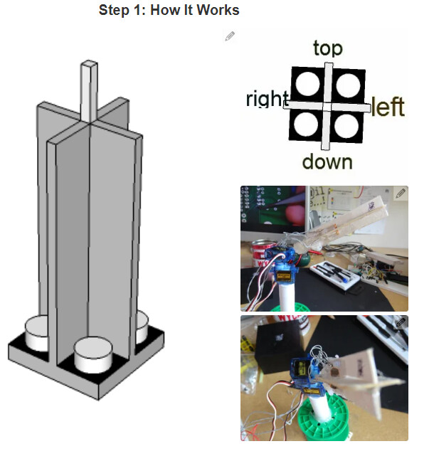

Hi, @amspen
Can you please post some images of your tracker, in particular the LDR sensor assembly.
Before you repost your code, press [ CTRL ] [ T ] , this will auto format your code and make it easier to follow.

You do have the X shaped visor on the LDR assembly?

Hi Tom. All values show 1023 in the sun and the X shaped visor in the picture, is near identical to the one I made, which I painted matt black.

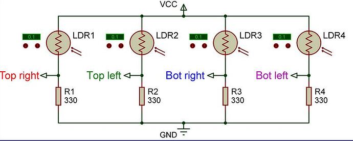

Sounds like a problem in the wiring or choice of components (the LDRs and associated resistors).
The wiring diagram in the original Instructables is nearly uninterpretable, and the 10K value for the resistors in the voltage dividers is probably much too large. Or, the ground connection is missing.
Something like this would probably work, with resistors of 1K or less:

Take @jremington advise in post #17, that should help.
The LDRs are saturated even in the shade of the sun.
The diagram you are showing is the same as what I made.
The only difference is the resistor value, mine are 10K.
I will replace mine later with 330 Ohm, as you suggest .
