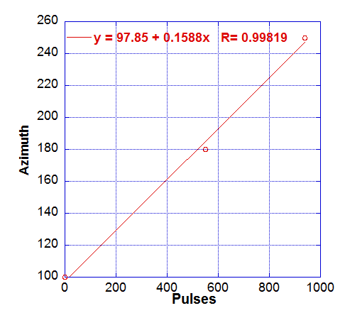

My linear actuator has a hall sensor inside, I connected it and counted all the pulses from lock to lock. Now I would like to associate the position of the actuator with an Azimuth.
The acutator range is 0 - 939 pulses
Position 0 would equal 100 degrees Azimuth
Position 550 would equal 180 degress Azimuth
Position 939 would equal 250 degrees Azimuth
Not knowing how to do this I looked up Arrays and Strings and none seem to fit correctly.
Eventually I would like to compare Solar Position Azimuth to Array Azimuth to make the actuator move to the closest position.
Unless you take the trouble to physically align the tracker platform base to North, you need a magnetometer (used as an electronic compass) for a North reference. The MPU6050 doesn't have one.
Using a straight line fit, the equation to convert encoder pulses to azimuth angle is approximately:
int angle = 0.159*pulses + 98;

I'm blown away that you came up with that equation so quickly, but I don't know how to implement it.
I can copy the line int angle = XXXX+XXXX but unsure what to do with it after that.
The equation does exactly what I understood your request to mean. (change "pulses" to "position" if you like).
Perhaps you should explain what the above means to you, and what you want to accomplish.
Its the code and how to use it that confuses me.
I believe I am understanding after a little thought.
int pulses = 0;
if(pos.azimuth < angle);
digitalWrite
Please have a look. I'm positive I have made mistakes or taken the long way around. Improper use or placement of brackets.
