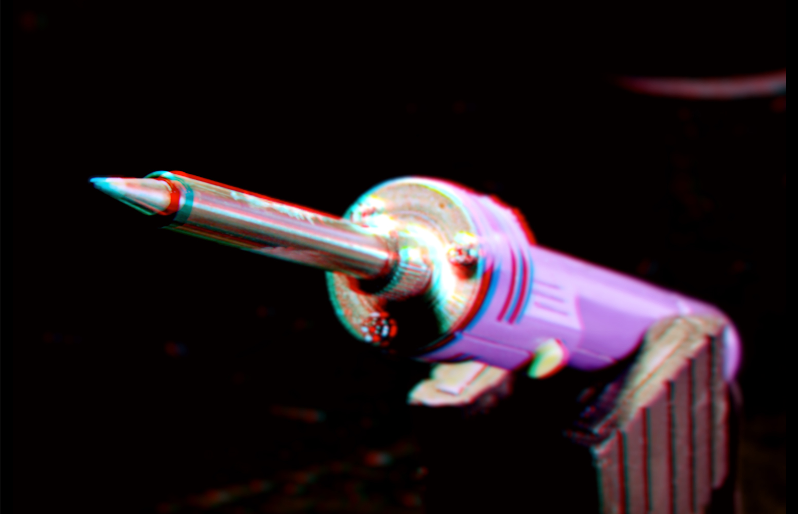

My favorite is the Hakko Presto. It's got a 'boost button' that temporarily increases the power to 130 watts from it's 20 W normal state. Here's the iron I've been using for about 4 years now:
[![](https://europe1.discourse-cdn.com/arduino/original/4X/7/0/f/70fe2253e5c5c8bb84b77497eab333937e71d06a.jpeg)
 Put on your 3D anaglyph glasses (red/cyan) and click the image above to see it bigger, in 3D!](https://dl.dropboxusercontent.com/s/i5gmzmj2lusf17g/hakkopresto3D.jpg)
