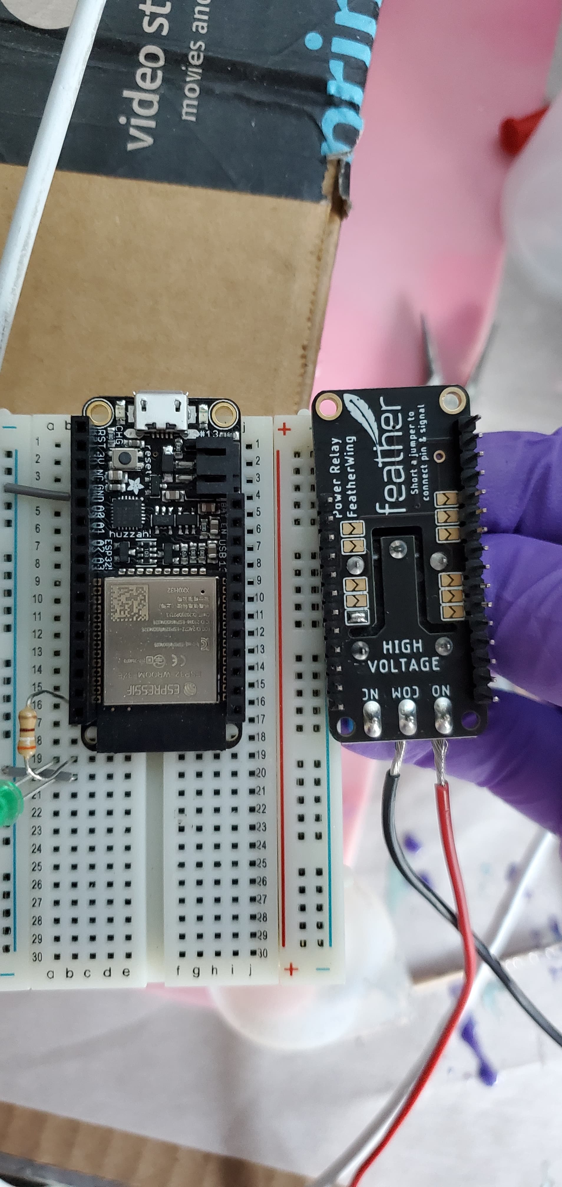

Hi, I have an ESP32 (Adafruit HUZZAH32) and am connecting a FeatherWing power relay that I'm trying to use to switch on/off a solenoid through the web page. But for some reason, every switch of the relay or two, the ESP32 freezes and becomes unresponsive. I have to reset the ESP32 to get it working again and I'm not sure what's going on.
The solenoid I'm wanting to control is 24VAC and below is a picture of how I wired it up:
I also read on this forum that adding a flyback diode might help. So I went ahead and did that but that didn't seem to resolve the issue. (I'm unsure if I actually wired up the "flyback diode" correctly) Here's how I wired up the "flyback diode":
I probably have all of these wire up incorrectly, which might be my problem.
Here are some pictures I took that may help:
Your guys' help is much appreciated, thanks!

A flyback diode will not work with AC, you need some form of "snubber" circuit across the contacts of the relay.
I assume if you disconnect the solenoid the fault does not occur?
If you Google
24vac solenoid snubber circuit
It will show you some solutions that may help.
That diode is most likely blown. Throw it away.
You are driving a 5V relay with an ESP32 GPIO pin. Yea, no wonder you are having issues.
It is not a relay, it is a relay module.
And it is not a 5 V relay in any case, but a 3.3 V one.
I use the optically isolated relay modules for the ESP32, they work better, for the ESP32.
Hi Tom,
You're correct, if I disconnect the solenoid, the fault does not occur.
I will look into the snubber circuit.
