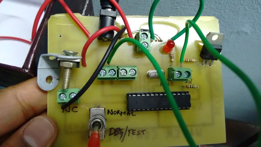

Here is what I am seeing:
  1. When the failure was seen (ie., solenoid just continued to remain ON indefinitely), the system was using OUTPIN[2], i.e., offtime of 12 hours and On time of 10 seconds.
  2. In debugMOde=1, the OUTPIN[2] should produce a pulse whose offtime is 110 seconds and On time is 10 seconds. Now, after resetting even this mode is not working fine. (ie., solenoid remains high for more than 10 seconds!!) . But, OUTPIN[0] , OUTPIN[1] and OUTPIN[3] are all working fine.
    Could the pin have been damaged?
  3. Next I started using OUTPIN[1] in debugMode=0. But even this failed after a couple of days.
    And now I am seeing that only OUTPIN[0] and OUTPIN[3] are working fine in debugMode = 1.
  4. If you see the circuit diagram, I have an option to connect the output signal to an LED or a solenoid. When LED is driven instead of solenoid ALL four OUTPIN[] are working fine.
Hope I have explained it clearly.
What am I missing? TIA

TomGeorge:
Hi, what I don't see in your circuit diagram are bypass capacitiors, particularly on the ATMEGA 8.
Can you include your power supplies in the diagram and a picture of your project so we can see how you have configured the GND connections.
Thanks.. Tom...... :slight_smile:
Tom, I am not using capacitors anywhere.
Here's how my PCB looks:(not sure how much it will help)
The big screw+bolt is an improvised heat sink for the voltage regulator.
