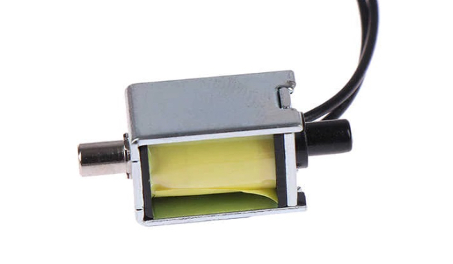

I have a small volume, like few ml, at pressure of 100Kpa, which I have to reduce to 700kPa at a variable rate, say 10-50 seconds. I was thinking of using a 5V mini solenoid valve which I plan to open and close rapidly, and I can experimentally find the frequency to flow rate relationship, then use that mathematical relationship to program variable rate of reduction of pressure. I think the end frequency should be anywhere between 50-100Hz. Can the solenoid valve survive this in the long term? Long term means 5-10 years. Anyone having experience with solenoid valves please let me know.

Its a science experiment for which i need to make a flow rate controller. Commercial ones are expensive. I need to change the pressure of a system at a controlled rate.
See I have no way of knowing whether its finally going to be 50Hz or 5Hz. what frequency would you say is safe for this? And why can't this solenoid valve take high frequency?
  • It would be impossible to move the heavy metal armature, for the spring (if any) to respond, for the solenoid mechanical stop to survive at 100Hz, yet along to survive for 5/10 years.
  • You may run into a resonance situation when trying.

My main concern is, would the magnetic electrical mechanism inside it be able to take the quick on and off? Are we expecting any heating issues and subsequent failure?
The data sheet says Life test 30,000 times (500cc container, 11s/time)
So if you operated it only100 times per day, it would only last 300 days

I do not think your bit bang solenoid control will work in the longer term.

There is a good reason for that: they are designed for the purpose, and they last a long time.
I think that valve would work just fine for your project. The picture and description leads me to think it has the plastic tube all the way through to unit. Inside the tube is a spring loaded steel ball that blocks the tube. The solenoid pulls the ball back away from the blocking so the fluid can flow. When the current is interrupted, the pressure and the spring force the ball to block again.

I am using silicon tubing and steel clamps. The pressure is handled well. But @jim-p found the data sheet and says that says its life is just 30000 times. At say 100Hz, that would be 6000 times in a minute, and the thing would last just 5 minutes!! Should we trust the data sheet? Did someone actually test it 30000 times or did they just type in a better-be-safe-than-sorry number?
Use Google to see what "mean time to failure" refers to. I suggest a motorized needle valve will last forever. Or buy a real pressure regulator, which is also a needle valve assembly.
