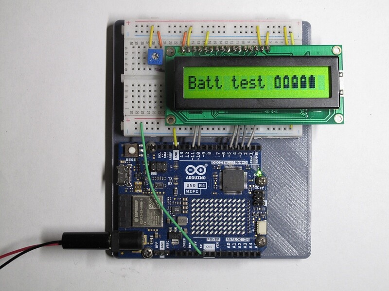

[SOLVED] 20x4 LCD code partially not working
I didn't write this code. It works as expected except for that part showing the battery icon. Currently it doesn't show anything. If I substitute with and ASCII character it prints it correctly.
I have voltage on the respective analog pin and it's reading it correctly.
Any help would be appreciated.

// Battery voltage monitor
const uint8_t  battery_adc_pin=A2;
const uint8_t  battery_states=5;
uint8_t        battery_state; /* 0=low ... 4=high */
const char     battery_state_icon[battery_states]={ 0x9F, 0x9E, 0x9D, 0x9C,0x9B };
const uint16_t battery_state_lowest_reading[battery_states]={ 0, 680, 720, 760, 820 };

probably this
is not compatible with the your LCD's character set
do you have a link to your LCD?
It's an LCD I got from Aliexpress:
https://www.aliexpress.com/item/1005006336854741.html
Characters on those Ali pics are not shown correctly for the blue version which I have.
Those have basic charset, typical hd44780 driven LCD
They usually have one of these charset
so no battery icon is available as a char entry code
you would need to use custom chars and modify a bit the code of the program
There are online character generator and I would suggest to use this library
Thanks for your suggestion. I tried this LCD Custom Character Generator:
LCD 1602 2004 Custom Character – Lonely Binary
but no matter of the string data it outputs 4 horizontal lines.
If I understand correctly { 0x9F, 0x9E, 0x9D, 0x9C,0x9B } is supposed to draw lines of top of each other corresponding to the battery voltage level?
I did not read it like that
this is the code
My guess is that 0x9F is a predefined character in their LCD's charset that represent an empty battery and 0x9B represents a full battery
when they update the screen they do
so they go get one of those 5 values based on the battery_state variable which goes from 0 to 4
what you would need to do with your code is create 5 battery icons, add them as custom chars from empty (0) to full (4) and then remove the battery_state_icon array and modify the way the screen is filled by using lcd.write(battery_state); where you want to print the custom char
I get your idea. I can generate 5 battery icons but it would be too complicated for me to integrate it in the existing code. I was hoping for an easy fix but it looks like this is not the case.
It’s an easy enough fix.
Build the 5 icons, share the code and I’ll see if I can update your code

byte battery_state_icon[8] = {
  0b01110,
  0b11011,
  0b10001,
  0b10001,
  0b10001,
  0b10001,
  0b11111,

I compiled this form a simple example:
#include <LiquidCrystal.h>
LiquidCrystal lcd(5, 4, 3, 2, 9, 7); // RS, E, D4, D5, D6, D7
// lcd Custom Characters
uint8_t Battery0Char[] = {0x00, 0x06, 0x0F, 0x09, 0x09, 0x09, 0x09, 0x0F};
uint8_t Battery1Char[] = {0x00, 0x06, 0x0F, 0x09, 0x09, 0x09, 0x0F, 0x0F};
uint8_t Battery2Char[] = {0x00, 0x06, 0x0F, 0x09, 0x09, 0x0F, 0x0F, 0x0F};
uint8_t Battery3Char[] = {0x00, 0x06, 0x0F, 0x09, 0x0F, 0x0F, 0x0F, 0x0F};
uint8_t Battery4Char[] = {0x00, 0x06, 0x0F, 0x0F, 0x0F, 0x0F, 0x0F, 0x0F};
  // Initialize The lcd. Parameters: [ Columns, Rows ]
 lcd.begin(16, 2);
  // Send The Custom Characters To lcd's CGRAM
  lcd.createChar(3, Battery0Char);
  lcd.createChar(4, Battery1Char);
  lcd.createChar(5, Battery2Char);
  lcd.createChar(6, Battery3Char);
  lcd.createChar(7, Battery4Char);
  // Clear The lcd Dispaly
  lcd.clear();
  lcd.print("Custom Characters:");
  // Print The Custom Characters
  lcd.setCursor(6, 1);
  lcd.write(byte(3));
  lcd.setCursor(8, 1);
  lcd.write(byte(4));
  lcd.setCursor(10, 1);
  lcd.write(byte(5));
  lcd.setCursor(12, 1);
  lcd.write(byte(6));
  lcd.setCursor(14, 1);
  lcd.write(byte(7));

Yes I did. I was connected to the USB cable only and it showed empty battery. When connected to a power supply (7VDC) it shows half full battery but there's a 20k/20k voltage divider going to the analog pin so I guess it has something to do with voltage mapping.
I tried that sketch and batteries look fine.
