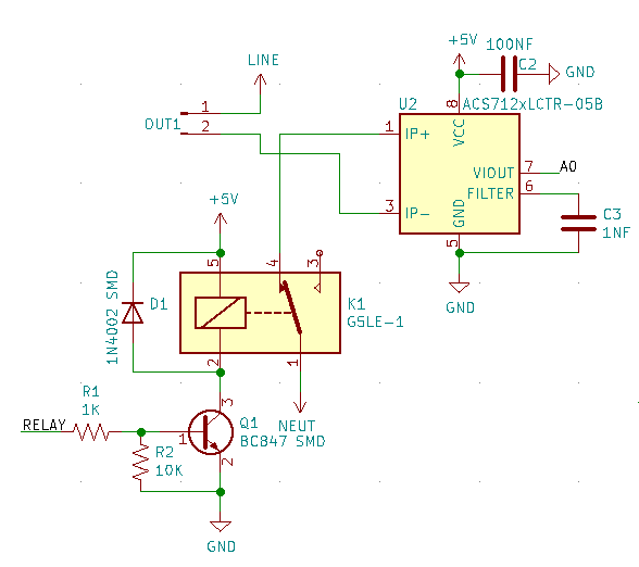

Show your schematic for one and two fans

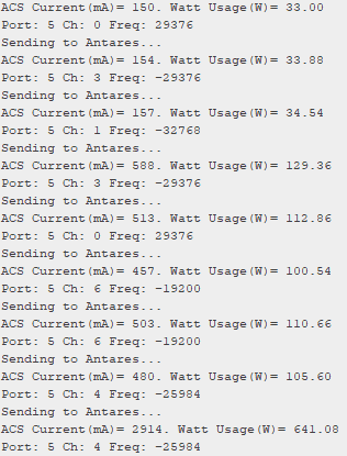

I was measuring a watt usage device using a single load (22W Fan) and it works just fine, below is the measurements result:
Then i measured my second fan (20W Fan) and here's the result:
And here's when i used both fan as the loads.
Wierdly, the image show the watt is not working normally. I used Wattmeter device for comparison and it shows 40Watt but the ACS seems not working normally. Tried with other load too and there goes the same problem again.

I already answered you in the last topic - give a schematic of your connections

Yes, this is the connections im using on the ACS712
I do not see the fans in the circuit

your calculation overflows the int.
try
float Watt = ((220L*mA)/1000.0);

Yes, because im using a table fans not a DC Fans. The Table Fans connected to an electrical terminal which is controlle by my device.
It works! Thanks for the help!
Used 4 Loads that is Phone 10W and Laptop charger 45W, 22W fan, and 500W electrical teapot. The rest is fluctuation around 10-15W.
