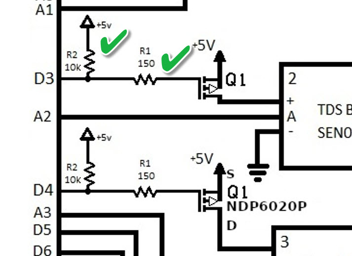

Hi everyone, last month I asked some advice to build my system adding mosfet. Now I am wondering if the resistences that I put between and the mosfet are good... I would feed sensors with 5V, the source is 5V and the mosfet that I choose is NDP6020P. (https://www.onsemi.com/pub/Collateral/NDP6020P-D.PDF) .
I followed this guide (https://www.gammon.com.au/motors) and I put 10k resistence and after 150 resistenze before the mosfet.
After some tests i mesure the volt in the drain and they are less than 5V. I ask you what resistence should I put before the mosfet?

What is the voltage across the Drain to Source on the MOSFET ?
Mmm the source Is 5V and the drain 3.95.
No.
Measure the voltage from the Drain to Source on the MOSFET (i.e. across the MOSFET) when the MOSFET is turned ON.
How can i measures It?
We assume you have a DMM ?
Also, is the Gate voltage going from 5v to 0V if you toggle the Arduino output pin ?
And, the output pins are indeed set to OUTPUT ?
Yes i have
Red lead on Source, Black lead on Drain.

Okok I put the Red on source and the black on drain but I read 0 on DMM.
Yes the Pin Is setted output but I can t see if the toggle the Arduino :frowning:
Can we try this again ?
Red lead on Source, Black lead on Drain, Arduino output pin, which is connected to MOSFET gate, set to give a HIGH (5V).
Also time to show us a good image of the actual wiring, and your sketch.
Okok thanks, I change the wire and now It run :blush: I tried a very simple sketch:

I noticed that the drain isn't 0V when the pin is 5V, is it right?
The value is 0,45V

i modified my ex post adding more details about output volt from the drain, in your opinion could it be a problem for my sensor?
In the guide, he's switching the low side with an N-channel MOSFET. However, on your schematic, you're switching the high side with a P-channel MOSFET. In this case, an NPN transistor should be added between each P-channel MOSFET and the control pin.
I think it would better (and simpler) to switch the low side.
In this case, 0V on the Gate of P MOSFET turns the MOSFET on.
The Drain, ideally, should go to 5V when Gate is 0V.
Due to the MOSFET’s internal Rds(on), a small Vds will be seen.
Rds(on) is ≈.041 ohms.
If you are seeing .45V (when the drain current is small) it might be your MOSFET is iffy :thinking:
Try a few different MOSFETs to see if they all act the same.
The same MOSFET here, with the Drain current at 1A, gives a Vds = 0.06V
