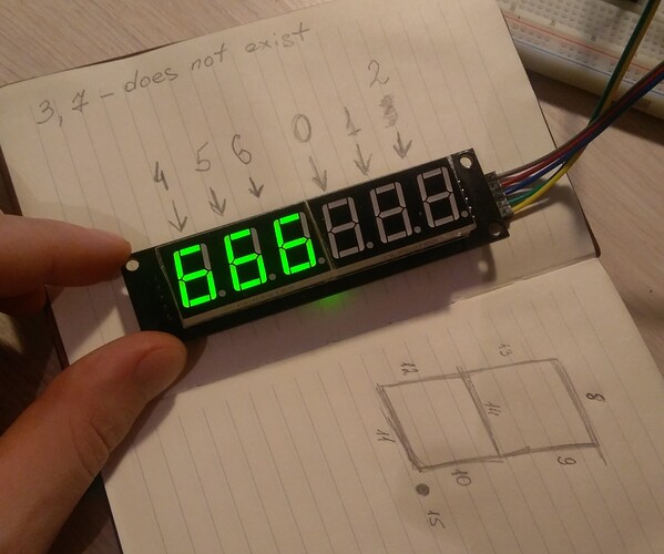

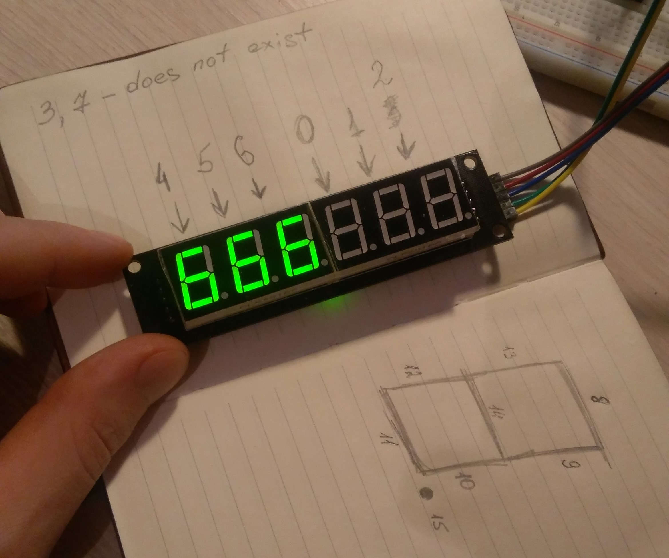

The posts above gave me some ideas in which way to look and there is some progress on this display. I fiddled with another example I found for using 74HC595.
Because I have two of those, which extends each other, and there is a single serial input pin, i thought - if one chip is 8 bits, then 2 chips is 16 bit, right ?
I wrote a test function to experiments with register bits. And this is what i found out.
An extended 74HC595, indeed, has double the bits. 16 in this case.
Also, fiddling and the schematic confirms this, first 8 bits (first chip) are used to switch entire digits off or on. This design and wiring can hold up to two 4-digits displays, and this is two by 3-digits. Therefor, 4th and 8th bit doesn't do anything, they are responsible for missing digits.
Last 8 bits (second chip, with current limiting resistors) are used to light the individual segments of the digits.
This is my testing sketch. Now that the principle is somewhat clear, everything has to be structured.

The result output of the function, is "666" on first 3 digits. Screenshot of the sketch and result.
From what I can work out looking at your code, these are common anode devices.
To switch a digit on, you set it to 1. To switch a segment on , you set it to 0.
Yes. Since the two shift registers are daisy-chained together, you write out groups of 16 bits
The next step for you is to display a number consisting of 2 (or more) different digits.
Then you really start using multiplexing.
To extend you example of working with an array, it would look like this :
                    1 1 1 1 1 1
0 1 2 3 4 5 6 7 8 9 0 1 2 3 4 5
0 0 0 0 0 0 0 1 0 1 0 0 0 0 0 1    // bits 0 - 7 turn on digit 1 only. bits 8 - 15 show a 6
0 0 0 0 0 0 1 0 0 0 0 0 1 1 0 1    // bits 0 - 7 turn on digit 2 only. bits 8 - 15 show a 3
In a loop, you'd write out line 1 first, then line two and it should display 63.
In your example, you are going off the end of the array with this: " for(int i=16; i>=0; i-- )"
because element 16 doesn't exist. The array subscripts are 0 to 15.
