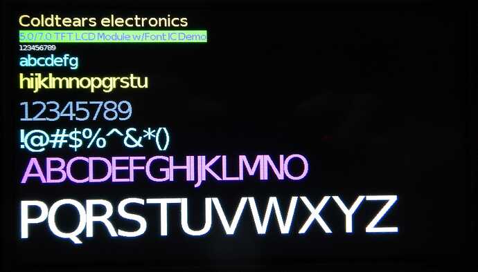

Hi all,
I wonder if anyone with a CTE 5" or 7" would mind or could possibly give me the dimensions(pixels) of these fonts please?
If I had one of these, I would not need to ask, in the meantime, someone surely could help me out please?
BVS_13
BVS_15
BVS_19
BVS_22
BVS_28
BVS_34
BVS_43
BVS_52
BVS_74
BVS_112
Thanks and regards,
Graham
Hi Graham,
I have a 7" TFT with a Winbond 25Q64BVSIG SPI flash memory installed.
from the demo code of 'CTE_70inch_800x480.ino', the following fragment can be found;
//Font selection
//BVS= Bitstream vera sans, suffix = font size in pixel (height)
#define BVS_13 10
#define BVS_15 12
#define BVS_19 14
#define BVS_22 18
#define BVS_28 22
#define BVS_34 28
#define BVS_43 38
#define BVS_52 53
#define BVS_74 78
#define BVS_112 122
As for the width, I do not know if it is the same as the height without flashing if the display.
Hope this helps for now.
Kind Regards,
Gary
Graham,
Further to my post below, I have just found and flashed up my unit.
#define BVS_34 28
The BVS is a proportional font.
For the above example, the visible part of a capital T is 21 pixels high and 18 pixels wide. A Capital W would be wider.
So the pixel width varies.
I hope this helps some more.

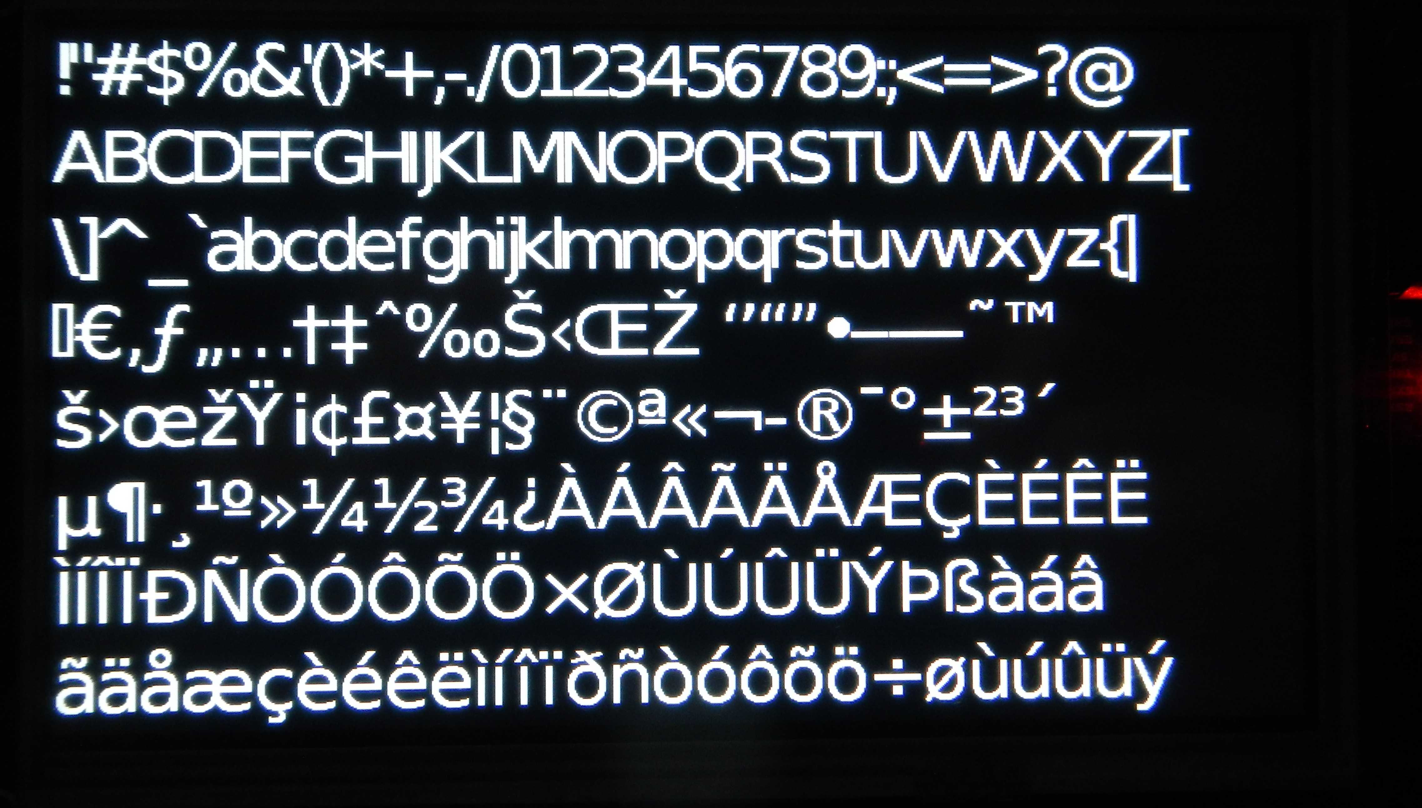

Hi Graham,
The last W would not be vertically aligned.
I have attached to photographs for you.
Of course, you can use fonts drawn by the Arduino, but there may a speed penalty by not using the on-board font IC.
I use TFT displays, Only one of my displays has a font IC on it. It is quicker to write text using the font IC.
It would depend on your requirement.
See attached pics.
