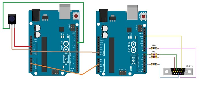

So my question is: Can I use a spare arduino board to receive the IR signal and then connect this board to the other arduino in a way that it will mimic the function of a button being pressed?
I hope that makes sense. Any help would be greatly appreciated and I have added sketches for receiving and sending the ir signal. As well as the current button counter increment sketch and my attempt to include the ir functionality into it.

Hi everyone. Firstly, just thought I'd say thank you to anybody who may have taken the time to read over my ramblings and download the attached files.
Secondly, through more tireless reading along with plenty of trial and error, I was able to resolve the problem.
I got out the multimeter and began to check the behaviour of the OUTPUT pin and everything was just as it should, but where I was going wrong was with the initial states of pins. Once this was sorted I began to see a trigger on the monitor which was increasing the counter randomly. But after applying a slight delay to it, the infrared button signal began to work as it should.
I have included an image of the setup, as well as the two sketches with the modified code as it could well help someone else.
