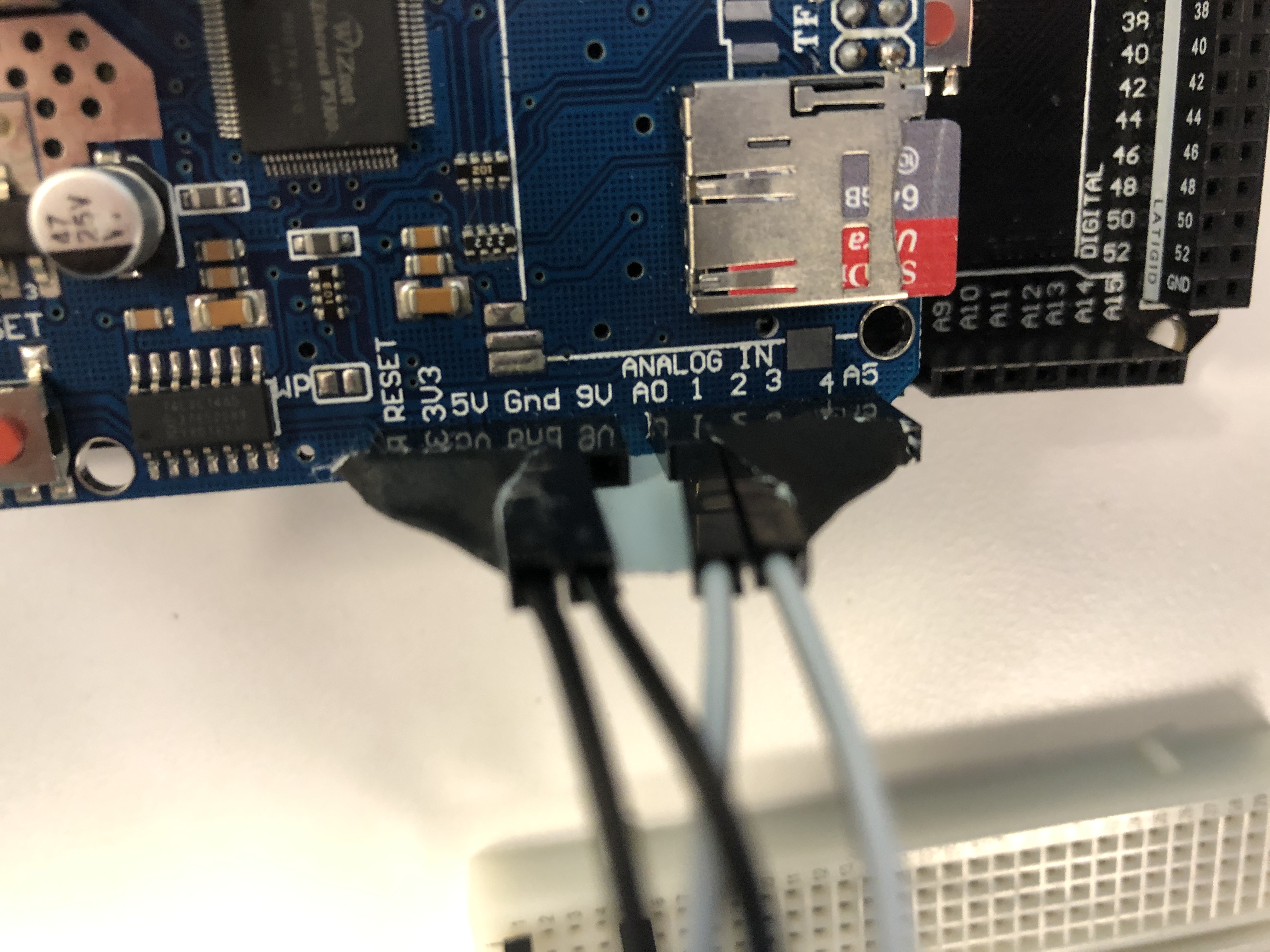

Please forgive syntax or noobish errors as I am effectively brand new to Arduino.
I am trying to develop a data logger that will read and then store the voltage for 2 batteries that will be simultaneously discharging to other devices. Both batteries are lipos and have operating voltages between 3.7 and 4.2V.
I used this example sketch as a starting point, modified it to use A0 and A1. I successfully read the values of the pins, view the Serial Monitor, and confirm that the file was saved to the SD card. However, when I connect the batteries, both pins are pegged at 1023. Oddly enough, even when only one battery is connected both pins still read 1023 or very close to it.
My understanding is that the Mega has a 10-bit resolution thus reading 0 and 1023 for 0V and 5V, respectively. I hope this is not a stupid question and I don't get flamed for asking it - if there is a resource I have missed please kindly redirect me to it.
Image 1 - overview of setup
Image 2 - pinout

Try the A8 and A9 just in the case
Went ahead and tried this - same results, pegged whenever battery voltage is applied

Basic fault-finding - can you check with everything else disconnected - especially the ethernet shield?
Didn't see anybody else already mention it, but connecting a voltage source (battery) directly to a pin is a sure way of eventually blowing the pin (or the whole processor).
Always use a (10k) resistor between batt+ and pin, so you don't phantom-power the processor through the pin in case you forget to connect (USB) power to the board.

I'm blown away by the speed and quality of the responses by this community. Thanks so much to everyone in this thread who pitched suggestions and helped me solve my issue.

Here are some notes on this setup: the Mega has an internal 5V reference. A voltage that exceeds 5V will require a voltage divider circuit.
Adding a large resistor (10k used here) between the positive battery terminals and the sensor terminals is a recommended preventative measure, since without it there is a risk of bleeding voltage into the chip and skewing the data.
As soon as the board is powered on, it immediately starts writing to file (after the 10 second delay). Therefore one should attach the batteries (or whatever DC voltage source being measured) before applying power to the board. The sketch could be modified to write the data to file only when the voltage is within a given range, for example.
The sketch won't overwrite any info on the file if it already exists on the SD card. That means that you'll have to remove the file from the SD card when you're starting a fresh run of data collection. With some additional modifications to the sketch, one could create a file naming system that checks for existing files and adds a version number to the new file when it's being created. But that exceeded the needs of my scope.
Here are some photos of the final setup
